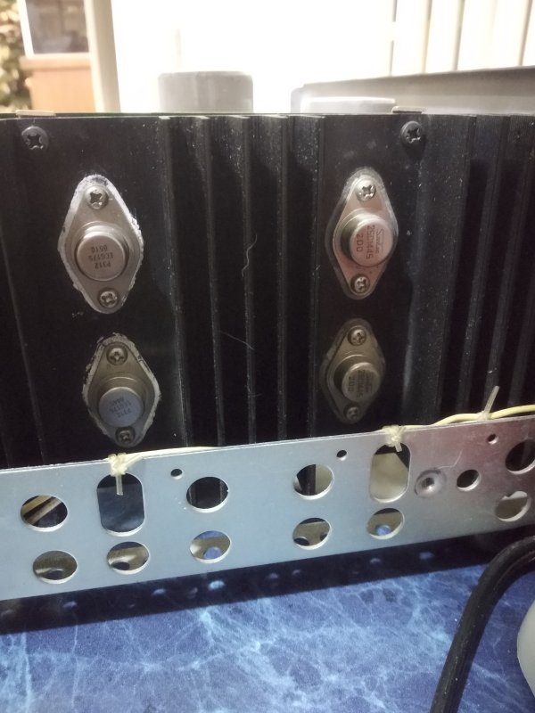

Hello! I recently got a 2440 unit, nice shape, horrible sound!!, it has a pair of 2CS1445 transistors on output stage and a pair of NTE175 in the same stage, so, i think it has been repaired/modified befor.

Unit has installed 2 - 2sc1445 and 2- nte 175 transistor. So. where coud i start?

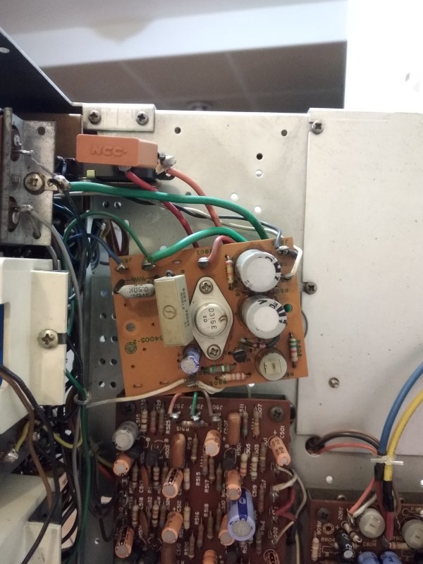

So, i have to say H802 transistor (2sd315) run hot when unit is tured on. No sound on front left channel.
I couldn´t adjujs bias to 20mV in the channel what is affected by R730... resistors r729 works fine for its channel, adjusted to 22mV, but R730 dont tuns more than 1/4 spin.
I recapped the power supply, and test it offers 35V......

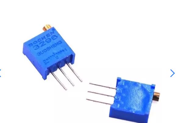

Will be appropiate to change them with the trimpot shown on photo above?

i have worked on the amplifier board, i changed: H001-H004, they was 2SC1445, i installed NTE175 (4, news).
