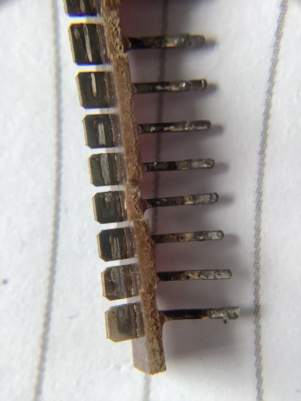

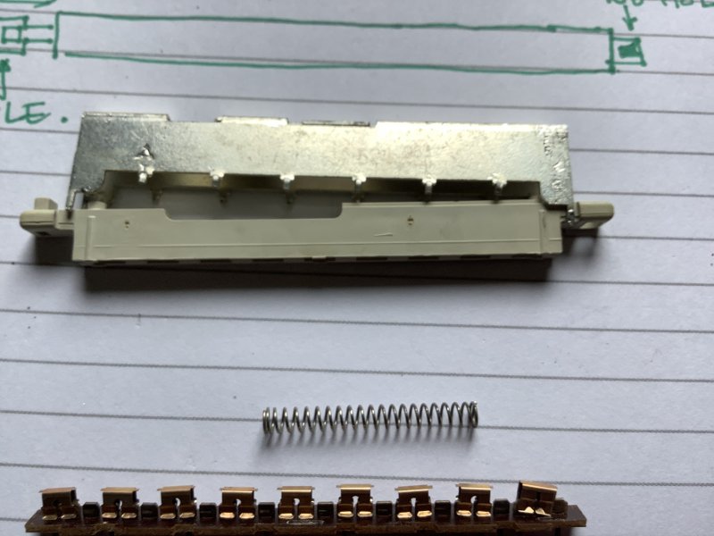

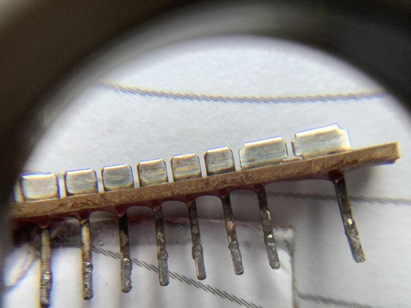

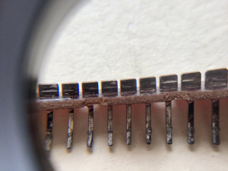

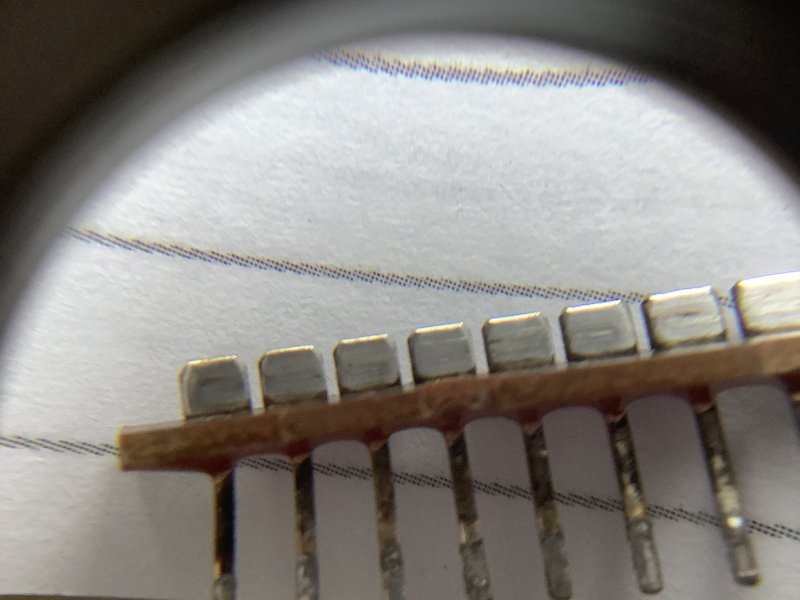

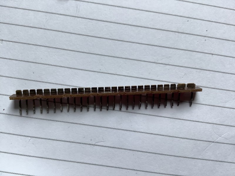

Hi everyone, Recently my 5020 has been having intermittent audio issues.
I have traced it to the PLAY -REC switches on the PCB. Tried Deoxit on it but didn’t yield any improvement.
I decided to desolder the switches and try to fix it.
What I found after opening is the contacts were covered with black layer of dirt. I cleaned it with rubbing a piece of paper without any cleaning solvent. it shined and I fixed it back. Now it woks like a charm. Just wanted to share it here so it helps someone. Will try to add pics.

I recently started having issues with my Marantz 5020 as well. Upon playing a cassette, the right channels VU was off the charts and the right channel’s audio was harsh and magnitudes louder than the left.
it was working a few days ago so not sure what could have caused such a drastic change in just a few days. I opened it up for a visual inspection and it looked pristine as I had last seen it - no obvious issues on the boards and no water damage. I then inspected the PLAY / PAUSE / REC / STOP_EJECT etc levers. I could not locate the parts you included in your images. Would you mind helping me figure out where those contacts are!?
I went pretty heavy on the Deoxit pretty much anywhere I saw a connection. Happy to report the tape deck is playing normally now. Still, could not find those pets in the images.

That switch sits on the left edge of the main board, with the switch plunger facing the transport. There is a lever from the transport that moves that switch in and out varying distances, depending on what mechanical switch lever is pressed. You can't miss that long silver switch running left to right. If it is dirty - and they usually are - all kinds of malfunctions will happen. For me, a good Deoxit cleaning has always worked. But if that doesn't work, it might require disassembly and cleaning like the OP said.
