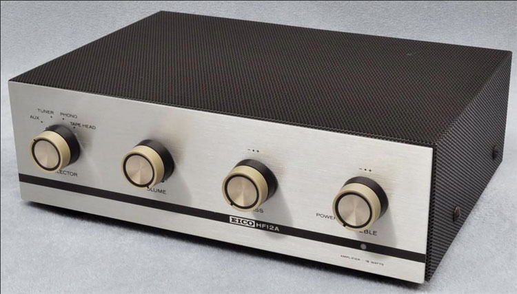

I also have a Carver H9AV holographic processor that has a dedicated L+R center out. I feed that to the Eico mono amp to add a center channel to all my other sources, switching back and forth as needed. Both feed a Bose VS100 speaker in the rack.
