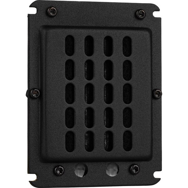

When I Googled 'MartinLogan replacement tweeters', this popped up.
Damned near identical replacements. $40.oo each.
There's even one customer that claims to have used them on his Mosaics.
So I now have a solution to the tweeter issue.

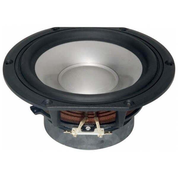

So out of curiosity, I looked for '6 1/2" Aluminum cone speakers'.
The dust cover is an 'outie' vs ML's 'innie', but everything else seems to be the same.

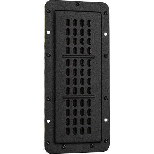

Tweeters are BG NEO3 planars. Parts Express sells the original for 96 (Have the back cups on them, but can be removed), and GRS replacement version for 40.
Meniscus has the original NEO8 PDR midranges for 209 each. Parts express has a GRS look alike version for 63, but It is 8 ohms .
As Steve said above… and probably the most important item is the Crossover as these planar drivers are great but only if can meld them together due their frequency response characteristics.
