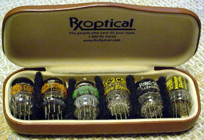

I think you'll find that the tube side will give you more satisfying results than direct out though. I played around some with that when I first got my D1, but it's been a while since I switched. For me, it's more of a tube rolling kinda thang if I want to change the flavor of the sound.
Hmmmmmm .... Tuesday ... that's TungSol Day!
And there's no switch for that either! <G>
