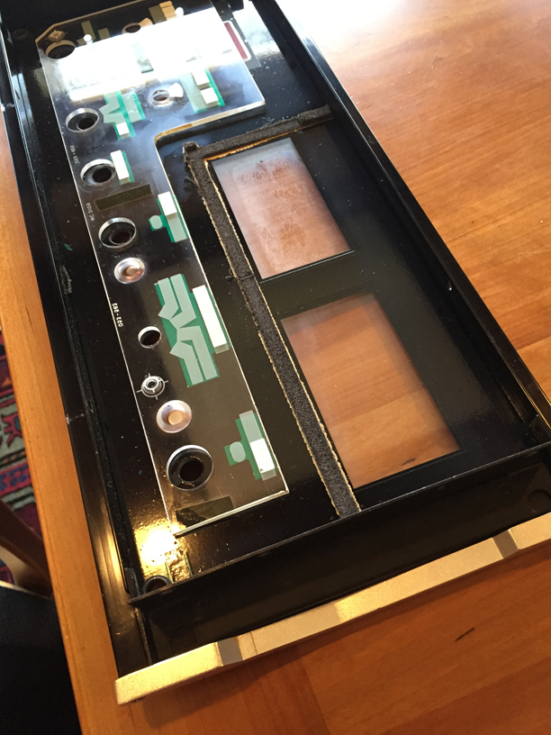

Can you provide a picture of the other end of the front panel? The glare masks the section you are interested in.

Thanks, all. This is the MC2150 in question. On these metal face amps, does the green color come from a diffuser behind the face, or is the plastic piece itself colored green?
I will take a guess and say the 2120 series is close to the 2150 series regarding the metal front panel. Here are pictures of the front of the chassis and the back of the front metal plate for my 2200.
The red lamps have two red filters; one taped to the chassis and one to the back of the front plate. I'm guessing Mac wanted the red color to be deep. The green lamps have one filter on the back of the plate. I am guessing that the green filter was placed on the plate because the green lamps are on all the time and there is an air space between the chassis and plate. If the white cup for the green lamps are closed (as the case for the red) it might get too hot and damage the plastic.
BTW, my 2200 sits like this all the time without the front plate because the plate is terribly dented.
John
John, that's so helpful! So probably I just need a new green filter on the back of the front panel. Next time I've got the amp out of its case I'll take off the front and check that out.

That would be a good time to put new light blocking foam strips around the filters. My foam was shot and scraped away.
Notice also that there are white filters to diffuse and soften the light from the lamps.
A while ago I did pull the faceplate on the MC2150 and I found that, as expected, the green filters had faded to near-white in the spots right over the faceplate holes. Maybe it sat in sunlight or near a bright light for much of its previous life? I was able to shift the filters a little to get green light once again showing through the faceplate.
