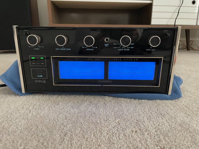

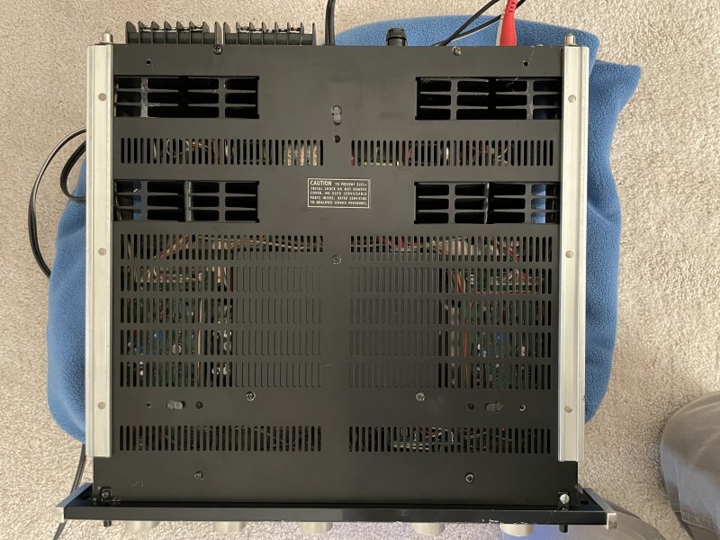

My dad and I went over the 2205 thoroughly - checking all connections, Deoxit, general cleaning up, etc. Many suggestions of which we discovered in this community. I'm having an issue in consistently getting the left channel to recognize an input signal. It works one minute and then not (more on that later on). In the below videos I'm only placing my finger on the other end of the RCA cable to provide some resistance and watch the meters. No speaker cables are connected. Rear switches are in 2.5V, Stereo and Normal for Power Guard. Fuse is intact. Why is it upside down? I'm listening for the relays to switch on and keep an eye on things.
Working just fine:
No Signal:
Here's the truly bizarre thing: If I leave the 2205 upside down, it works 100% of the time. Right side up = maybe 10%. It's like she doesn't like to be moved. o_O In the second video, I had just moved it and that is why it wasn't working.
Any ideas or recommendations would be appreciated. I have a diverse vinyl collection that's ready for our listening pleasure!

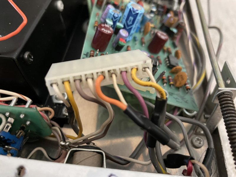

Went back through everything and found the Left Channel PCB had an issue in this connector. She's right side up and humming along! Thanks for all the suggestions.
Is that a new photo? It looks like you still haven't replaced the two German burgundy 10uf bipolar caps on the board. These are well known to fail due to old age.
