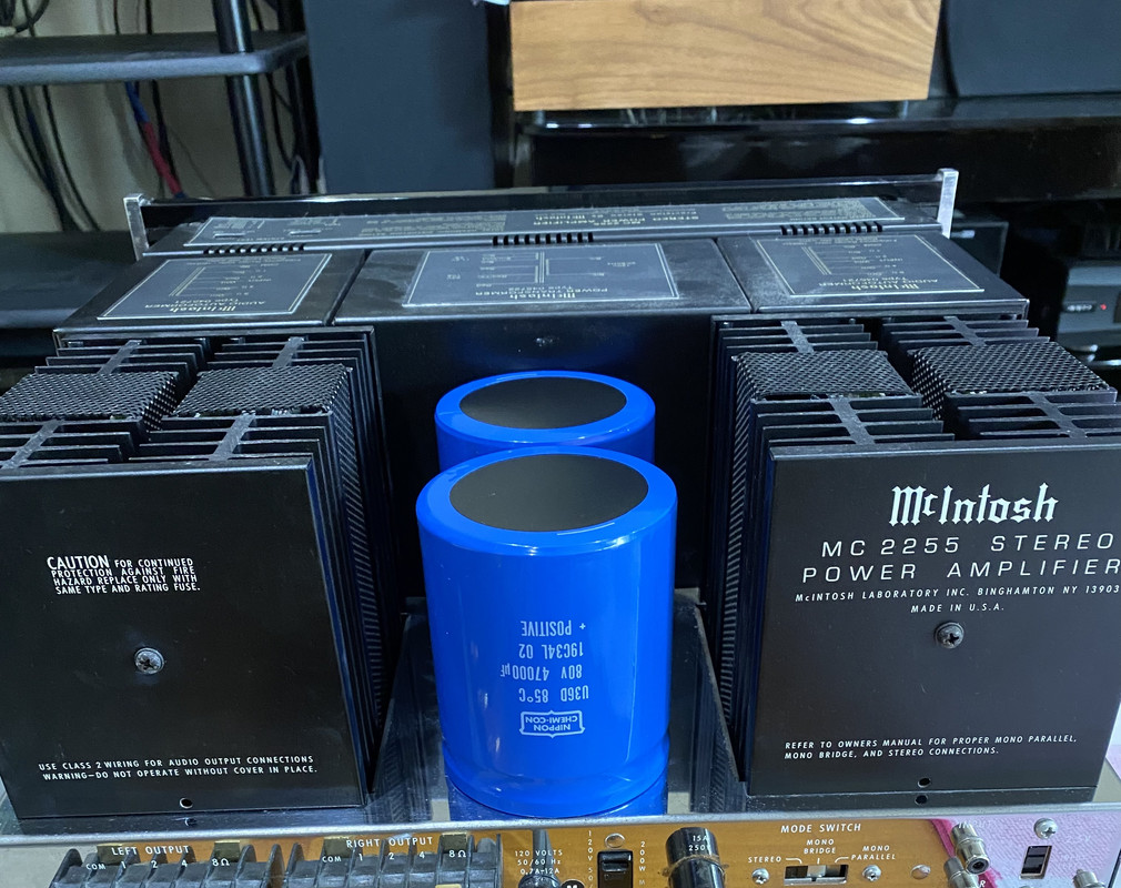

@captouch, I don't have a service manual for the MC2255 and would like to know the original specs (voltage, dimensions) of the two big main filter capacitors at the back of the amp.
I wanted to change those capacitors since capacitance is no longer at specs and purchase the proper capacitor in online (mouser). I thinking of using Mallory (Ryan of AC suggested this) or Kemet brand.

I sent you the Mouser part # in email on 5/15. The part# is E36D800HPN473ME92U
Diameter is 3”, height is 3.625” (which is shorter than original, which is about 4”), 38,000uF value. Besides the height, which is just cosmetic, it’s an exact replacement/fit.
Looks like this after replacement:
Thanks, is the original voltage of the capacitor 80v or lower?
He fixed it now and I'm considering also replacing the two main filter cap.
Oh, got it. Great, glad to hear it was resolved. The power on self-test board is indeed a PC-type interface board that I can see might not be seated properly. Maybe that was it.
The original spec is 60V. So 80V exceeds original spec, but that's not a problem. If you were to put in a 47,000uF/60V cap (if you could find one), it would likely be smaller diameter or shorter, which would look worse. So I'd just go with the one recommended if possible.
