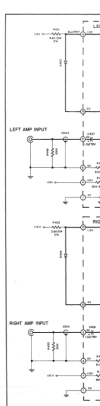

mcintosh mac 1900 receiver driver board transistors numbers needed please help!

Yes. I mean No! I do not think this diode/transistor is the problem. Mine has just a barely visible dot, no writing. It is just the only component that is out of parameters/faulty on the left output board. Last three times I have turned the power on, the resistors pictured in my post (mislabeled MAC 1900 output transistor replacement- Jon Weston) have burst into flame, so....I'm a little cautious. I want all the leads from the left board to read the same resistance as the right board, which does not catch on fire, before I try again. That one Germanium transistor on the left board is shorted, ...0.4...1.1ohms. The right output board, or D413, is about 80ohms. Current meeting no resistance, and rushing to the 10ohm resistor, is about as good an explanation for the flames as I can think of.
At least, realizing there is no resistance where a diode was expected makes me hesitant to turn it on one more time, so I'm looking for a transistor-that-can-be-made-into-a-diode which will give me the same 80ohms I get with the right channel board (all in-circuit, so where that 80ohms actually is I don't know)
OK try the last part number I have posted 070-xxx

Another precious informations that you will find nowhere
Page with the commercial reference of this transistor orderable with a diode part number code and not under ref 132-xxxx
and now an original drawing made by factory many many years ago

and replaced the tiny little diode on the reverse side of the left output board with a Germanium diode, which I've almost concluded was the problem that got the whole cascade of smoke and sparks I've been working through going. Since replacing that, neither the 5watt cement resistor, nor the 079 driver trans next to it even got warm. If that diode goes, becomes shorted, it seems to cause the middle driver trans (132-079) to just dump power continuously into the junction of the .33 ohm cement resistor, and one assumes on into the MJ15003s. Two more of which have replacements in the mail now.

Got all my 1900 output board replacement components and soldered them in. Double checked everything because, with all the confusion, repeated smoke and flames, though very brief, the back side of my left output board is not a a very pretty sight by now. Whatever old school solder was originally used....it does not mix well with the ROhS compliant stuff I've been using. I think there must be at least 100° f difference in the melting points of the two.
Anyway, all seemed....well enough. One driver transistor was giving 100K+ ohms off of one lead where no continuity/connection would be correct according to theory and comparing with the other board.
Fired it up and...turned it off real quick because, well, there are no light emmiting diodes on that board but there, indeed, was a diode emmiting quite a bit of light!! My goodness, the very same one I had just mentioned replacing in my last post.
AND SO I HAVE LOCATED AND CONFIRMED WHAT HAD BEEN THE PROBLEM ALL ALONG!!
This might, in fact, be of interest to the general MAC community (at least in pouring over related threads for weeks now, I've never heard anyone mention it)
Folks have noticed, noted, and posted confusion re:replacement transistors in depth, and width, but in case nobody has noticed, there is an actual typo in the schematics of the 1900 service manual:
The diode on the back side of the 1900 output boards, drawn with dotted lines running diagonally from the left lead of the middle driver transistor (132-079, the only PNP of the three, I think) to the proximate lead of the cement .33 ohm (bias?) resistor is clearly labeled "D414" or "D413"
But it is not!
D414 and D413 are actually the PNP Germanium metal can transistors made into diodes by twisting the B and C lead together. All of this is clearly labeled and diagramed about an inch or two to the left on the same schematic. (Thanks again to whoever explained all that to me when I needed to replace the "real D414")
If one considers carefully the parts list and schematics in the service manual, however, one will notice a D403 and D404 in the list that does not exist anywhere on the schematics.
One would also note that these diodes and only these diodes are spec'd as silicon diodes,that is to say NOT si. signal diodes or Germanium diodes etc., this being shorthand for "current diodes" or general purpose diodes, the only diodes spec'd as such anywhere in that neighborhood. So if you did as I had and tried to go by channeling the spirit of like items/components...you can keep doing laps around that circuit, putting in some other wispy signal or otherwise qualified diode, which will immediately fry, usually short, and dump 40v or -40v right into the MJ15003 output transistors, incinerating resistors along the way.
Fortunately I cut off the power quick enough this time to save one of MJ15003s on that side (I got a spare along with the replacements most recently, but only one)
In conclusion, that diode hiding on the solder side of MAC 1900 output boards is actually D404 or D403, and needs to be much beefier than any of the other D4XXs.

Working from the 4X230 - AL9999 service manual, but in regards to D404 & D403, they appear throughout all of the service manuals available online.
In the middle working on a unit with 2 different board revisions, one missing the "rear diode", and stumbled across this thread. Thought I'd share what I've found.
D404 & D403 are attached to the heat sinks towards the bottom, and soldered to a standoff mounted near by. They can be seen in the schematic between pins 15 & 10. This is a stabilizer diode, P/N 070-046, which is the NLA MZ2361.
In regards to the "rear diode", the part number is incorrect both on the schematic, and the board view. It appears to have been forgotten all together when it came to the parts list, but I can confirm that it is actually P/N 070-047, which crosses to a 1N4148.
