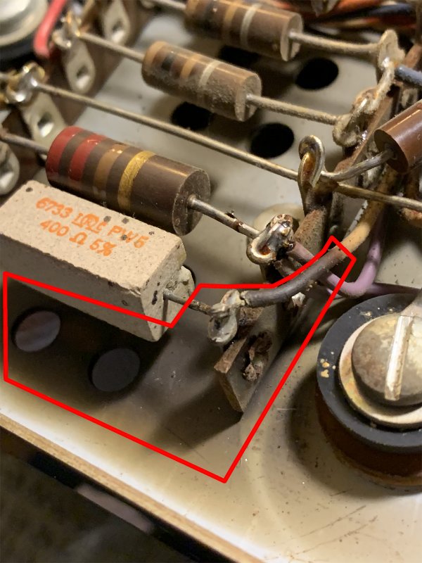

I recently hooked up my MC 250 to a MC 112. It worked wonderfully for 20-minutes and then I noticed a slow chimney of smoke coming out from the heatsink and the smell of burnt electronics. I quickly unplugged the unit.
I opened it up and saw that a white wire was burned black and that area of the chassis had black soot on it under the resistor.
It turns out that the white wire connects to R70 (400 Ohm 5W 5%) over to the rectifier between D17/D19. The part of the wire towards the diodes is fine. The value of the resister is spot on. What could have caused this? Would a bad diode(s) cause this?
The Service Information booklet does not show the value of the diodes. I am assuming all the rectifier diodes are 1N4820 (1.5A 400V). Should I just go ahead and replace all the diodes D17 - D20 and D13 - D16?
I have included two pictures for your reference.
I am just above a novice when it comes to repair. I have ordered all the electrolytic caps to do a restoration on the unit. But want to make sure I am using the right diodes for the two rectifiers.
Again, I am most interested in your opinions on what could have caused this.
