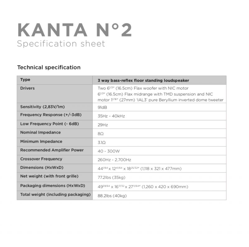

I have a pair of Focal Kanta 2's (specs in pic) and I'm trying to find some Mac gear to go with it. I was going to go with the MC275 and C2300 but after reading these comments I'm thinking about checking out the MC60 and MC30. However, these speakers are rated at 91db and a minimum of 40wpc. I'm wondering if the MC30 won't open them up enough, so at minimum go with MC60. These speakers are a bit warm sounding I think, so it might bring that warmth to the MC60 pairing. Any thoughts on amp pairing with these speakers?
Note, they are currently being powered by a pair of 60wpc homemade tube amps and tube preamp by John Miller. I really enjoy the sound but have lusted after McIntosh equipment for years. I'm hoping it will be a significant upgrade to sound but impossible to tell/research because of the homemade nature of my setup (no reviews, etc).
