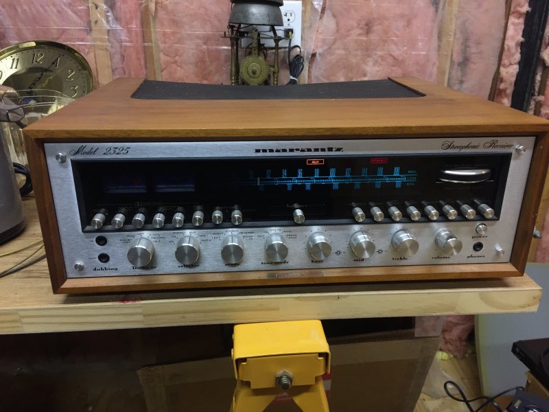

Sorry for the delay..... We were moving into our new offices.... I finally got all 4 speakers in my new office... Right now I have set up one in each of the 4 corners of the room and the right and left channels are diagonally across from each other...
I did this just to test out the " new pair " that I got so I dusted off my Marantz 2325..... see photos below , I acutally got my first pair and the 2325 as a "system" from a clock guy I know.... he had it for 20 plus years , and he also got them as a "system".

So I am using a Marantz 2325 for now i have the speakers layed out in the 4 courners of the room ..... one set is on "main" and the second set "remote" speaker terminals...
I already found the bad middome.... I also using a MQ-104 for the low end EQ,.,,, keeping the four band passive EQ , in the "OFF" position... I just want to adjust the low end eq like a MQ-102.
So you see one set on side where my desk and amp is ..... mirror opposit wall ( apporx 20 feet away )... are the other set...
