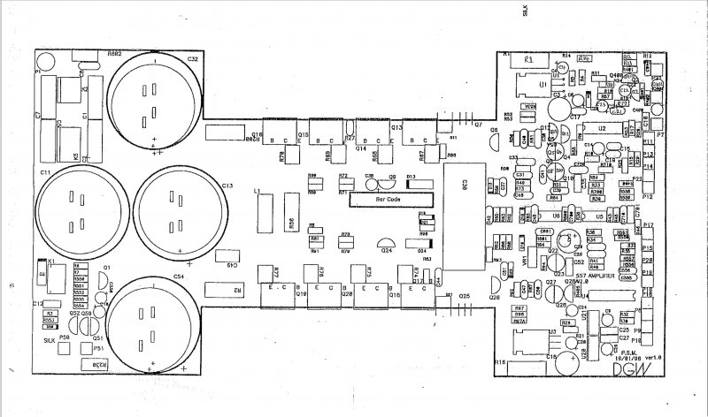

I don't have a photo since I haven't disassembled the amp yet but here is the official board diagram. The two in the middle labeled C11 & C13 are missing from all 557's I've seen so unless they are present on a few from the first production run, they probably were never used. Since C11 & C13 are between the bridge rectifier and the regulators they would typically be used to increase DC voltage under load and reduce ripple into the regulators. C32 & C54 are between the regulators and the power transistors so perhaps they decided the power transformer provided so much current and C32/C54 did such a good job of filtering that they weren't needed? I would love to hear if anyone knows why these were excluded. I can't think of any downside of including them other than cost factors (and air circulation but these run very cool) so I'll probably just buy an extra set of the 10,000uF/80v caps and add them when I recap.

Not sure what you mean by C11 & C13 missing.
They're the big black with gold text ones in the bottom middle of this picture.
Wasn't this from your amp?
If you look at the board diagram above you will see there are 4 circles and connection holes for big caps but they have only populated 2 of these locations with capacitors - C32 and C54. The other 2 circles are for C11 and C13 but they do not have any capacitors installed in those locations. What I mean is that they are completely traced and connected on the circuit board, they are just missing from the board.
Regarding the picture, I screwed up. That is a picture of a project someone did with their 557 and I accidentally posted it instead of the correct picture. Here is the right one. You can see C54 and C32 at the top right and left. If C11 and C13 were installed you would see them below those caps and a bit towards the front and rear:
Well C32 and C54 is probably enough for the filtering. I agree, might as well install C11 and C13 but of course those caps typically cost some money.
Which one is the white one in the middle? Must be a big one as well.
