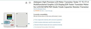

I have another cap tester somewhere I'll have to find and maybe see if I can open it up to find why it doesn't work. From what I remember it didn't work right from the start.
Looked something like this one:
