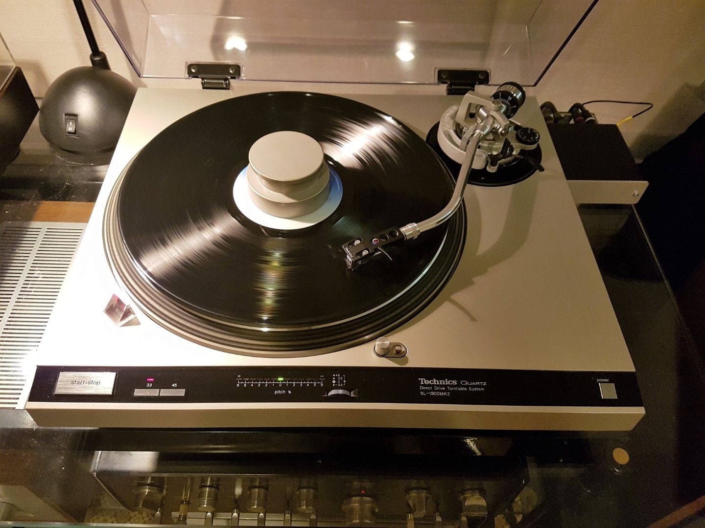

Sort of like this SL-1800 Mk2 I had:
Note the KAB fluid damper. It also had the wax spindle thrust pad from KAB and upgraded interconnects.
