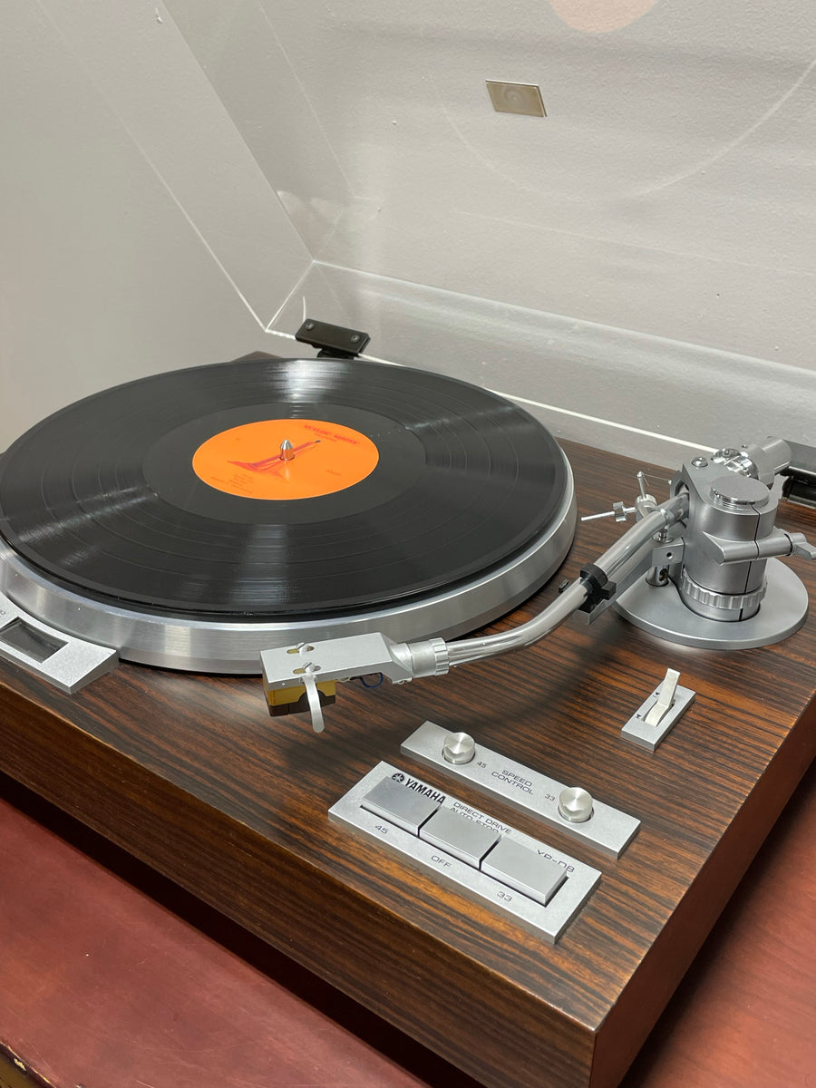

Looking to modify my YP-D8 with a new RCA jack plate.
My tech has offered to fashion me one from parts.

It is my vintage Yamaha YP-D8 turntable!
(Not the actual unit, but can't send photos from my phone to my computer right now).

Time got away from me on this thread! We went ahead with a black plate, some RCA jacks from PartsExpress, and a Vampire Wire connector.
But! I'm getting hum when the motor is operated.
1) We tried grounding the TT internally -- slight hum when motor is not operated; hum when motor is operated.
2) We added the Vampire Wire connector. No hum when motor is off. Hum when motor is operated.
Is this ground loop? The table is in the same Furman as the rest of the system...
Any thoughts? Thanks!!

Did you already measure the resistance beween the outer contacts of the RCA jacks and the separate ground jack?
And a few pics of the modifications could be helpful - so one could see, what exactly you been doing.

Normally the RCA jacks don't want any connection to each other or the chassis. Thats the job of the ground lead. If the insulating shoulder washers weren't used, thats probably your issue.

Hi again, lini! Thanks for your input.
My tech was out of town, hence the tardy reply. He has reported that the resistance between signal and ground on each channel is 480 ohms. "Both channels measured the same resistance ... figured it was a small ground loop between the signal grounds and the plate they were attached to."
Here are some pictures, and they are perhaps pertinent to @gadget73's reply.

Update: Tech has written back and reports:
"The insulating ground washers were used and there is no ground connection from the signal leads to the chassis. Though the chassis ground does connect to the RCA jack panel." He thinks that if that was the issue, we'd be hearing hum regardless of whether the 33 or 45 switches are operated.
Yeah washers look fine, I was only curious in case it had been missed. Not all jacks come with those.

Yes, i also had one installed in my turntable so i could play around with cables. Speaking of cables, have you tried using a different set from what you are currently using? Sometimes its the cables that cause the hum - maybe there’s a cold solder on the jacks, maybe the cables aren’t shielded, etc.
Thanks for for your reply, @mdc701. The cables are new Blue Jeans cables LC1 that I ordered in expectation of this new modification; I hope the chances for their being faulty / unshielded are low. I have not tried any other RCAs, but I do have a separate ground wire that I could try with a separate pair of Worlds Best Cables RCAs.
One hypothesis we have is that something maybe went loose in the drive from tech to me, though he lives only a few minutes away! So maybe it's cold solder? TBD
