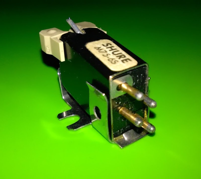

Looks like you're not actually using the clip the way you're supposed to. Remove the stylus, hook the rear of the cartridge under the tab first, then swing up the front and snap it in. This will take some pressure. It's a very secure system that weighs next to nothing, and probably cost next to nothing to make. Which was probably the main benefit, back in the day when Shure was putting these out by the millions.
You're right that the clip can be "slippery" under the screwheads, but when used as designed it has a very secure grip on the cartridge.

To you, I guess, although Donal may have the same issue. Can't tell for sure from his photos but yours in post #20 clearly shows the cartridge is sitting at the wrong angle. That's what happens when you don't hook it under that tab. The rear of the cartridge body, where the contact pins stick out, must end up parallel (nearly flush, actually) with the "holding arms" on either side.

GREAT EYE!!! What you pointed out caused me to do another inspection of the mounting mechanism, and just like you said, the rear of the cartridge was sitting ON TOP of that small rear tab on the clip, NOT in front of it and hooked in so when you push the front up, it makes a very solid snap into place. Mine kind of snapped into place before, but NOTHING like it does now. This should make keeping the whole thing more stable more possible when working with those dang "feet" and the mounting screws.
Donal, have a look at how yours is mounted and make sure that you follow bangforbuck's instruction. On the clip, you will see a small "nub" at the rear where the cart makes contact. Position the cart just slightly ahead of that and push the rear right up against it. Now, snap the front of it in like he said and it will be MUCH more secure.
Thanks a bunch....owe you one! See pic now of correctly fitted clip:
Properly mounted M75, which is the same body as your M91

Yeah, only wish I had a clip that looked like yours.....mine has the feet that look like Donal's in his first picture, post #1......way more fussy to get on there tight unless, again, I just don't know how to do it properly which is very likely based on I didn't even know how to properly put the cartridge in the clip to begin with!!!:confused:
Oh, I see, those screw ears are open towards the front, not the side. That can be helpful or a PITA, depends on the situation. Try mounting the clip by itself and then clipping in the cart.

That is precisely what I wound up doing, mounting the clip first and then snapping in the cart (however wrongly at first). Now the situation is at least partly under control as the cart is just MUCH more stable in the clip.
I got some styli in from VOM recently and one was for this cart. So, I installed it and had to adjust the overhang. It is a PITA. When I start something , I sometimes get tunnel vision, and can't see anything except what is at hand. I shoulda used washers. I think things woulda gone a bit easier.
I think, with the particular clip you and I both have, washers will really help hold the thing in place while trying to tighten down the screws. Or, if you can find screws with slightly larger heads on them.....that may help as well.

Ripblade, I understand the confusion as not all of these clips, according to what I've seen, are constructed the way mine and Donal64's are. Look at his first post and observe the configuration of the prongs on the side of the clip where the screws go. They are more like "hooks" and instead of being a hole, are open towards the front of the cartridge. Have a look at bang4buck's picture in post #27. That clip has the openings going to the side of the cartridge and would be far easier to work with. The problem is, with the openings going toward the front of the cartridge, when you tighten down on the screws they tend to "walk," as Donal points out, away from the area on top of the clip prong and make it really difficult to get the cart in the position you would like for it to be. Why they didn't just have two round holes instead of those hooks beats me, but that's what it is.....
So you guys are screwing in from underneath, with the nuts on top? I could see where a washer could be of some help, there....:idea:
The style with the sideways openings isn't immune to wandering, either, as the openings are significantly larger than the screw shank. Patiently tightening the screws a little at a time, alternating between left and right, helps.
