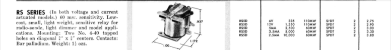

so once I got the original relay out I found the part number which is nowhere close the the fisher number. It’s a 5v relay which makes sense with 215v on one side and 220v on the other. Luckily I found an nos relay on eBay for $20. However I think it would fun to try to find a newer replacement but most of the 5v relays I found were super low resistance. IMG_1574.jpeg
Not a 5V relay.
2.5mA x 10kOhms = 25V
25V x 2.5mA = 62.5mW ("60MW" in table)
SPDT with 2A contacts
$3.80 each back then
Wow that is interesting. I was just going by the eBay description. I don’t k ow there was such a thing as a current relay.
It was marketed for use in plate circuits, for which the input voltage would be less important than the current required to activate it. Possibly it is just a 24V relay in disguise?
