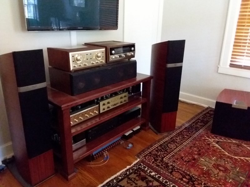

Not sure how to describe such a device, but I have 5 amps in one cabinet and one pair of speakers. Right now I have to physically pull the jacks from the wall and plug the ones in from the corresponding amp. Appears the correct description would be called an “amp switcher”
Is there a device that I can plug all my speaker leads from the amps into the device then only one set of leads from the device into the in-wall speaker jacks? Hard to explain, but if this is not clear I will try to get some pics of my arrangement.

My 2 cents:
Terminate the speaker cables with banana plugs.
Wire the amplifiers' speaker connections with banana jacks.
With the amplifiers powered off, you simply plug whichever speakers you want into whichever amp you want.
Use something like a Niles AXP-1 to switch the RCA output (e.g., from CD player) between the amps.
Unfortunately, all of the products that I use appear to be discontinued. In the attached photo, you may be able to see the banana jack configuration and AXP-1 switches under the equipment shelves.
you can find any number of break before make amp switch boxes on ebay, nearly all of them produced in china. amazon carriers many of the same, but ebay has a wider selection.
Break ( contact ) before make ( contact ) is compulsory for this job. Otherwise you will run the risk of serious damage.
BREAK BEFORE MAKE !!!

I use two amp switchers on two setups. One is the Specialty AV SP-71, the other a Solupeak P2. Both switch between two amps to one set of speakers. The SP-71 includes internal circuits that maintain load on the non-engaged amp to allow tube amps to be attached and maintain a load on their outputs. A quick search of ebay should locate similar devices with more amp inputs.
