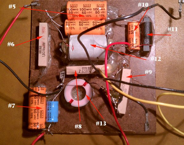

I just got the upper crossover out, and here's what it looks like
So now I know that #6, #8 and #9 are resistors and I don't have to do anything to them.
The caps here are #5, which like the example above is a 100 mfd plus a 60 mfd and I have a 100+50+10 that can go together as shown above
#7 is a 60 mfd and a 4 mfd and I have a 50, a 10 and a 4 for that one.
#10 is a 16, and I've got a 15+1 for that.
So what is #11 that's wired with the other 50 mfd cap?

#11 is an iron core inductor. It doesn't need to be replaced. The Dayton caps pictured are indeed 4.0 and 0.1 microfarad - uF, MFD, µF are all ways of saying the same thing. "Audio Grade" isn't really any specific measurement, it's more of a manufacturer's marketing thing like a product labeled "Heavy Duty" or "Long-Lasting". These Dayton film caps you have are an affordable, good quality capacitor, a good choice for speaker crossovers.

Those are Dayton caps, usually you get those from partsexpress.
They have 5% tolerance and are film instead of electrolytic. They have a 250V rating, and that is inherent of film caps of this type.

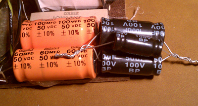

Need reassurance
I'm pretty sure this is right, but I could use some reassurance before I actually heat up the soldering iron!!
as shown, the original caps are a 100uf and a 60uf. My replacements are a 100uf, a 50uf and a 10uf -- and they are just wired together on the ends as shown, correct?
Yes this is correct. Wired in parallel. Since you're going through the trouble of recapping, you might consider using Dayton poly caps instead of those electrolytics.

The original is a 100uF and 60uF.
You have new electrolytics of 100uF, 50uF and 10uF, totaling 160uf.
Just replace the 10uF with film, it will essentially be a bypass capacitor and improve the sound most of the way, with far less cost and size.
Do the rest of the caps that are not in parallel with the drivers in film, and get electrolytics for parallel values.
Now I understand.... use the ones I already have for the 100uf and the 50uf, and just get the 10uf with film.
For the 64uf's, use the 60uf I have and get a film 4uf, and for the 16uf's, use the 15uf I have and a film 1uf! Or do I do this JUST with the woofer one on the 160uf ones. If that's the case, should I still use all film on the crossover for the tweeter?
