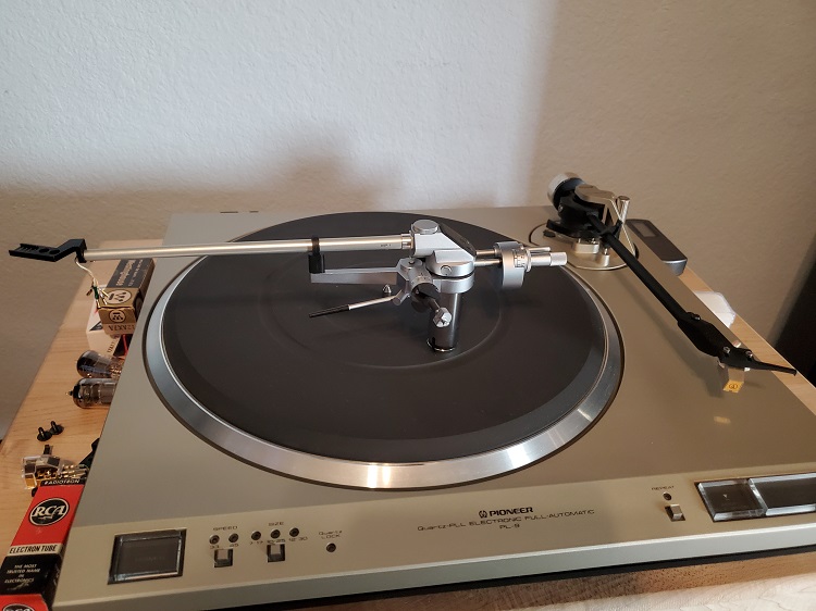

When it first got here, sitting on my old table, a Pioneer PL-9
I love the precision look of it, the underslung, micrometer style counterweight. I also love the fact that it uses a swappable arm tube system with a small contact board on a terminal block at the rear of the arm tube.
I have a few cartridges that are a good match for this arm, compliance-wise. The Audio-Technica AT-ML170/OCC, a Denon 301MKII, and an Audio-Technica OC9XSL. Spare arm pipes are not super easy to come by though, and aren't cheap when you can find them.

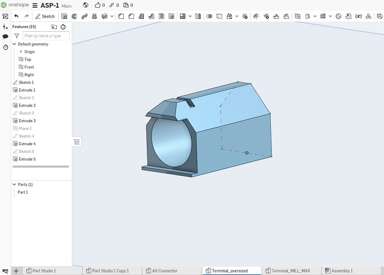

One day I was looking at the back of my arm tube and started wondering if I could design and 3D print the necessary parts to make my own spare arm tubes with carbon fiber tubing.
The design of the terminal and headshell went a lot easier than I thought it would. I've been trying to learn Fusion360 for a while with no luck really getting my head around it. I switched to Onshape and with a few YouTube tutorials to get the lay of the land, I quickly had models for the terminal block that holds the contact board at the rear of the arm pipe, and a headshell design that would allow for overhang and offset angle adjustment.
The prints came out great and the carbon fiber tubing I picked up from Amazon was a perfect force fit. I cut the CF tube to the right length for a 300mm effective length (12in) and glued the tubing into the terminal block at the rear. I left the headshell as a force fit for two reasons: Easy azimuth adjustment if needed and, the 3D printed headshell is not permanent. I will eventually have the headshell CNC cut in 6061 aluminum by PCBWay (who made my custom terminal block circuit boards, more on that in the next post).

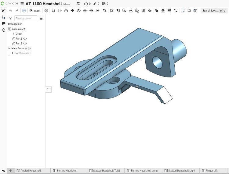

Another picture showing the 3D printed headshell and finger lift a little better. I designed the finger lift to countersink the cartridge screws so that the screw heads would not block the finger lift rotation by contacting the sides of the headshell.
As I mentioned above the goal is to have the headshell CNC cut from 6061 aluminum using the file I created for the 3D printing. The aluminum, while light, is not nearly as light as plastic and along with the extra leverage created by the much longer arm tube, the weight at cartridge end will no longer be able to be balanced by the stock counterweight at the rear. Thankfully, Audio-Technica also made an S-shaped tonearm tube for this arm, which came with a much larger, heavier counterweight.
