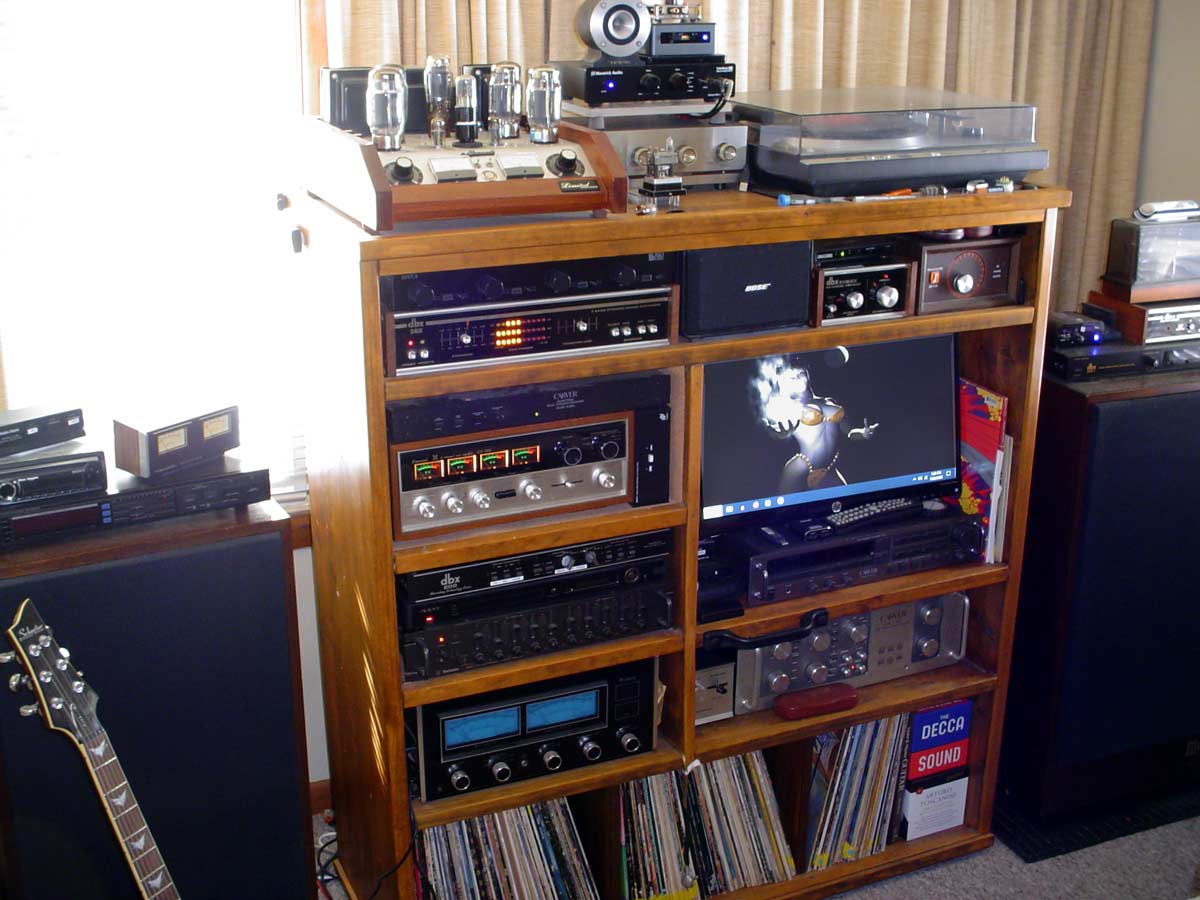

Now all ya gotta do is figure out how to set the balance on the thing ... luck wit dat, eh! I actually had to RTFM to figure that out.
Nice unit tho ... pre- vario matrix, but I always liked the synth on that better than the newer versions for non-encoded stuff.
** BONUS - My version of "where's Waldo" ... find the QS500! <G>
You want "different" ... currently driving the front channels in holographic matrix using the Carver C4000. Ain't blowed up yet!
PS - just noticed your location. Please to send me a wheel of Leyden ... BEST ... cheese ... ever!!!
