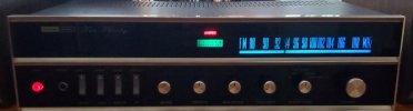

The listing said, “Harman Kardon 330A AM/FM Stereo Receiver - Tested. Tested Works but volume scratchy, pots need to be cleaned. Display bulbs outAs is condition. Please see attached photos for details” Photo below is from the listing.
I was so excited when it arrived. I unboxed it, took some quick photos, and rushed to share in Discord.
Embarrassed to say, I was so excited to have a Harman Kardon, it didn’t immediately dawn on me until my Discord post published, that I did not, in fact receive the 330a I thought I had bought. I rushed to the listing to double check.
I received a Three Thirty (ashamedly not knowing that was a thing). Anxiously, I messaged the seller informing him of the mistake, hoping I could get what I actually ordered. As I waiting for a response, I investigated the Three Thirty and fell in love with it too. It was a simple mixup. He grabbed and shipped the wrong box. The seller said he’d send the correct order and when I received it and inspected it, I could send the Three Thirty back. Instead, I made an offer on the Three Thirty. That will be a future project.
The 330a eventually made it. Nice.
I made sure all of the fuses were correct and cautiously put it on the dim bulb to see what I had bought. Indeed, scratchy controls, and intermittent right channel. If you held the Speakers 2 switch just right, you could get it to come in, kind of.

In my investigations, I’d love to say I was able to successfully diagnose the problem, but as I was testing voltage on the outputs, I slipped and made sure the one I thought was dying was good and truly dead. I was going to replace the outputs anyway, as noted in the HK bulletin, so that’s where I started replacing parts. It did fix the distortion issue!
Following dlucy’s post, I proceeded to recap the entire unit - chassis caps, filter cap, and all of the board caps. I am still learning to problem solve, so some of my solutions in replacing the radial caps are likely not “common practice.”
I read too much about the UFOs - they are good forever, they always go bad - I had replacements, so I replaced them on the predriver board (and the MPX beacon). The schematic was mislabeled and I’m grateful to my DCA55 to help me get the pinout correct. I learned to properly cross legs on the new transistors. Fun!
I also found a secondary heatsink on eBay, so I added that too.

I’m a bright lights girl so I upgraded all of the lamps to LEDs with one of Joe’s kits off eBay. I used a couple resistors in series to dim the bulb and one in parallel to bleed off the extra current. It doesn’t go fully out, but it goes full bright in stereo and dims enough when not listening to FM, so I’m happy.
I finished it up with a good polish of the metal face, knobs, and wipe-down of the tuning dial face.
I was able to adjust the original trim pots for balance and bias without them disintegrating, but I will be replacing the bias post soon. I was able to get one channel nearly to spec, but not the other. I just need to place the mouser order.
All in all, I fricken love this thing. It’s gorgeous and it sounds… clean. For the first time, I heard something in a song and thought I had done something wrong. Nope. It was a bad recording.
This 330a now lives in my bedroom paired with some Sansui AS-200 speakers and it’s absolute magic.
I learned a lot during this. Harman Kardon 330a traces are wickedly fragile. I had to creatively problem solve. And I'm ready for the next project.
