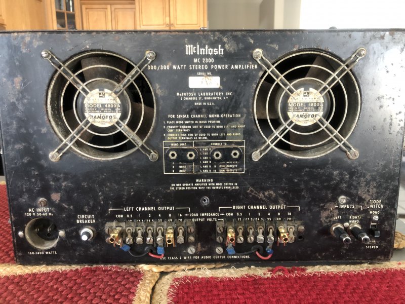

I believe I do have a banana plug speaker binding post - attaching images. There is definitely something there that I have not seen on the back of other MC2300's
Also showing a picture of the inside.

This amp has the thermostatic controlled fans - that's nice. You may flip the fans around to have them pull air through the amp vs push in. McIntosh made this change shortly after your amp was produced.
Interesting to see the banana jacks - hard wired right to the 4Ohm taps.
Can I use these to power speakers? Sorry for the super novice question!
You certainly could - if you had 4Ohm speakers. This was obviously a mod which greatly sped up connecting / disconnecting the amplifier during shows. Plus, it eliminated errors by the hired help.

<<snip>>interesting to see the banana jacks - hard wired right to the 4Ohm taps.
Aren't those 1/4" TS jacks wired to the 4Ohm taps? The other TS jacks have RCA adapters in them (inputs). The gold-plated adapters on the speaker terminal strips will work with banana jacks, I don't like them because you can very easily put too much load on those with the long banana plugs in them, with just an accidental tug on the wires.
