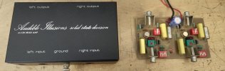

Hello! I recently acquired this interesting piece of gear and can find absolutely nothing on it! No specs, instructions, history, anything. I contacted the company about a month ago but never got any response.
I replaced and upgraded everything inside (the last pic was mid upgrade) but have no idea how to set any of the switches for proper function and I'd rather not break something by messing with them.
Appreciate any info on this in advance :)
The four pot of switches are probably loading resistors to adjust for different cartridges.
You can see the traces go to those resistors. This can be adjusted to correct value by listening.
The other switch on each channel might be gain as it is close to the transistor but IDK about that.
Are those two transistors the only active parts? Are they just single transistors? Do they have numbers/labels?

I will go and open the Head amp and get those numbers for ya. Think they are op-amps if I recall (they were marked). Edit: I was wrong, opened it up and they are : LM394BH super matched pairs of NPN transistors.

Someone that understands circuits could probably tell you if the voltage controlled variable amp application is used in this application and if that other switch might be gain control.
datasheet from Digikey
I could probably hook up my function generator with a 0.5mv signal to the inputs and see what my scope says on the other while I flip the switches (turning the power off in between switching) to see what happens I suppose :)
