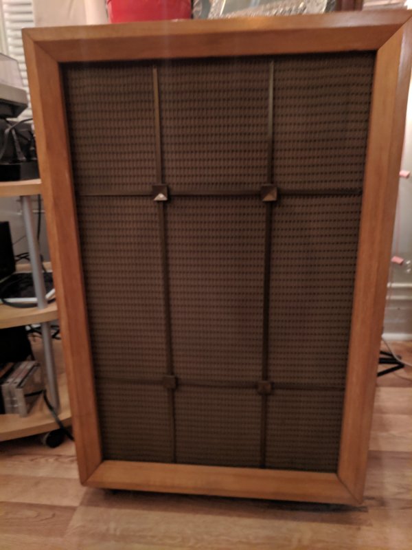

Hello, I was wondering if anyone could help me identify these mystery speakers. My dad says that when he bought them he was told they were studio monitors, made from a kit, circa late 50's early 60's. FWIW, I love the way they sound, on anything from vinyl to tape to CD to the television!
Any help would be appreciated!

After shining my flashlight into the grill at an angle, I have determined that the woofers are Electro Voice Wolverines (I have read these are the budget model of woofers?) and I can see a smaller driver to the left of the woofer and of course the horn above them. Does that make this a 3 way model? (I am still learning)

Yes, indeed -- sounds like it.
Drivers could all be Wolverine (e.g., an LS12 or LS12A twincone "fullrange" as woofer, plus a TW35 tweeter and MR10 midrange) or the MR and tweeter might be "better" EV models.
https://products.electrovoice.com/binary/LS8, LS12A and LS15 EDS.pdf
https://products.electrovoice.com/binary/HF1 and MF1 EDS.pdf
Nothing wrong with the Wolverine drivers. They were (and still are) relatively inexpensive, but were nicely made and sound fine. Indeed, some of them I prefer to the more expensive EVs (the EV Wolverine LT-12 coax being an example -- an unassuming but very pleasant little 12" coaxial loudspeaker).

Aristocrats! Sometimes taking a flash picture of the front at the right sort of angle will help reveal what's behind the grill. You probably already know this but these were designed to sit right up against the walls in the corner of a room, the placement helps the bass response. These will with very little power and will sound great with a tube powered amplifier.

The grill does slide out at the bottom. Couple of screws.
As soon as I saw the picture of the speaker, I assumed Mark Hardy would have the literature up. Nice to know he is still on the beat...
