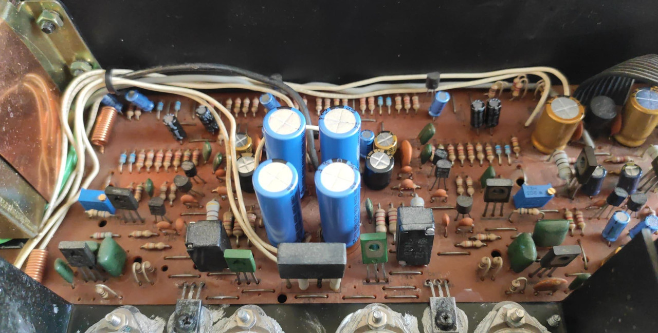

I have accured few problems with my NAD.
Firstly, when I turn the amplifier on, there is a Pop sound on speakers, or headphones (not loud, not terrible but still its exist).
Secondly, when i turn the amplifier on, there will be no sound for ~10 seconds. After that, sound would increase slowly, first on one side, when after 1-2 seconds on other side. After another additional 5-10 seconds sound will reach selected desired level of sound.
Thanks, for replies my friends
As well, how to adjust idle current, now RX1/RX2 has pot installed, and set to default value R180.
So I need to install 1k resistor parrarel with R653/654, and measuring across that 1K ohm resistor?
And the value need to be 30-60mV?
Thanks for clear answer.
Update:
In place of R653/654 its seems that's installed 1 Ohm resistor (Brown Black Gold Gold)
So do i need to install 1 kOhm resistor pararell to this 1 ohm resistor, and measure on 1 kOhm? 30-60mV??
As well before measuring it, I need to unsolder bridge (which is red circled)?
RX1/RX2 is 180 Ohm, as was resistor intalled before
Need answer asap, please :)

I just finished up a 3020, I think it’s the same as yours. You do need to remove the solder bridge and measure across the bridge for 30-60 MV. I solder leads on both sides of the bridge and attach my dvm To the leads. It’s just easier. I can’t answer your question about resistor values, since I’m not at home, but I can help you latter tonight with them when I can check my 3020
The startup problem my be your power switch arcing. Mine does the delay at startup. But I don’t have the pop
On later amps, the bias adjustment resistors (R645/646) are 180R, with a value set by the factory in parallel with them (RX1 and RX2). "Later" amps are the ones without the power supply board on the back, and the four caps in the center of the board. This also extends to A and B models, plus the 3120. I always swap out R645/646 with a 1K2 resistor, that makes the adjustment easier.

The picture above shows a weird looking thermal compound on the output transistors. Is it silver? I'm wondering if whoever worked on the amp before used the thermal compound that is meant for CPUs and other computer chips. This is NOT the right stuff to use as it conducts electricity. I would get this fixed sooner rather than later.
As for the resistors. You need to measure across the 1 ohm resistor with the solder short removed. I would also use 1K2 resistors next to the pots, and start with the pots at least 500 ohms, and work downwards.

Thanks, Lee :). Helped so much. Adjusted bias, thank you ;)
Cleaned power switch with contact cleaner, so now Pop is quiter :)
Only whats left is sound problem at begining, if it's not something dangerous, I'm keeping like that, will upload video, how it looks like.
I think (may be wrong) that this model has a soft startup mute circuit.
On the one I refurbished, which looks the same, upon turning on, no immediate sound, then the sound would “ramp up” to the set volume. This is probably some resistor capacitor delay that turns on a transistor in the preamp section.
So, either the resistor or capacitor is different between both sides, causing one side to come up to set volume before the other.
That’s my guess.

Hmmm... i think i need a clear schematics. And some research i guess.
I think that model Series 20 with four filter caps at the back and integral preamp supply circuit
is more like the 3020i schematics.
If you look at the last of the preamp section, Q309 and Q310 are FET’s used to mute the circuit.
Q516 and associated circuit slowly turn on the FET’s over a set time.
But looking at the circuit, both FET’s are turned on by the one circuit.
So, maybe the FET’s are mismatched. Different gate turn on voltages for each side ?

Hmm. The values are the same.
Forgot to mention. When i got it. It was all good. But one time i turned on. And there was a delay. Do not dropped or something like that. Happened itself
FOUND SOMETHING NEW!
Removed power switch at all, connected with WAGO
So, no turn on POP nor turn on delay!
What can cause that "normal" behaviour? Power switch or power switch capacitors?
When I connected red white. It's mutes. And after disconnecting need to restart amplifier, to make it play again. What is these Red White wires?
(So im thinking its power switch or capacitors?)(Or these red white wires is bleeding through some capacitors/resistors?)

The red/white wires do just what you discovered, they mute on power-off. If you are getting a turn-on "pop", then the AC points are shot in the original switch. That WIMA is a bit overkill as all you need is a "spark killer" cap, not an "audio-grade" cap. However it will work just fine. If you cannot find an original tandem switch, you can just do away with the red/white wires and it'll still work fine. But you might get a "pop" occasionally without them functioning.

There is a replacement power switch and a spark suppressor you can use. Neither of them are cheap, but they will solve the problem. The white and red wires are for muting. They are connected to the separate low current section of the power switch. These wires are connected to the normally closed part of the switch.
Mouser part numbers are :
Replacement power switch 611-NE1839EE
Quencharc for power switch 539-104M06QC100
