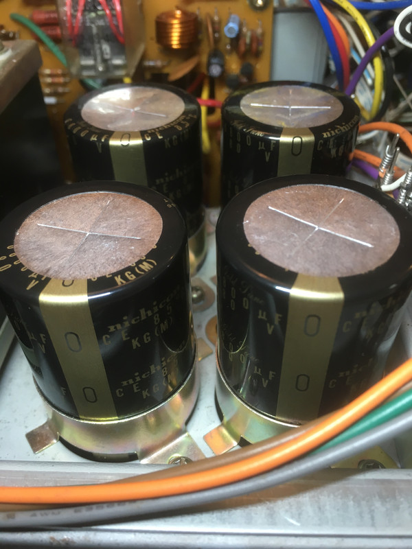

Hello,
I have an NAD 7120 receiver with a noticeable physical hum emanating from the power transformer. A low level hum/buzz is also audible through the speakers with the volume off, it increases slightly at full volume with no inputs attached.
I have already tried isolating the transformer from the case with rubber grommets. Any other suggestions? New filter caps? Some sort of AC filter? Varnish soaking the transformer?
Thanks in advance!

I removed fuses 1-4 as suggested. Unit did not hum under power. Nor did it hum with fuses 1 and 2 installed only. When fuses 3 and/or 4 were installed (along with 1 and 2) the unit started humming. Filter caps?

Probably not filter caps causing this. More likely the winding is loose on the bobbin (core) and/or the laminations of the core are loose.
If the laminations are loose, they may have gaps or be moving, and this can be made apparent by polishing or rust between the mag iron plates. If you observe this, try cleaning any rust from between the loose plates, coat with insulating enamel (Glyptal) and tighten the hardware or clamp the laminations together to set. Bare plates allow random eddy currents, causing unnecessary heating and efficiency loss, not to mention the noise.
If the laminations don't appear to have gaps or are not moving, the winding may be moving a bit. The winding can work loose, and it may be possible to shim it back into a secure mounting using solid plastic shims wedged into the space between the winding and laminated core plates. Place the shims at the center of the core if at all possible and let the outer portion of the winding float a little if you must. If shimming quiets the unit, apply some insulating enamel or varnish over the shims and winding area once they are securely in place.

Hi!
Very good advice from watthour and i agree with him, but not always is it posible to do so because of the way transformer is build
So if your investigation got you nowhere and based on your first post regarding hum on the speakers, i will sugest to change some capacitors with new fresh general porpose ones. If you solve the proplem then you can change for whatever boutique capacitor you want!
So if i was you i would change :
C307/308 4700/50 to new 4700/6800 uf /50-63 v
D301 bridge rectifier and associate c319-c322 0.022/250v capacitors.
The above are for power amp supply (F1,F2)
For the pre and mute circuit supply (F3,F4)
C309,310 1000/50v
C312,313 220/35v
C311 100/35
Check R311,312 10ohm 1w if in spec and check if burning marks.
Check zener diode D304 (36v).
All these parts are really cheap.
