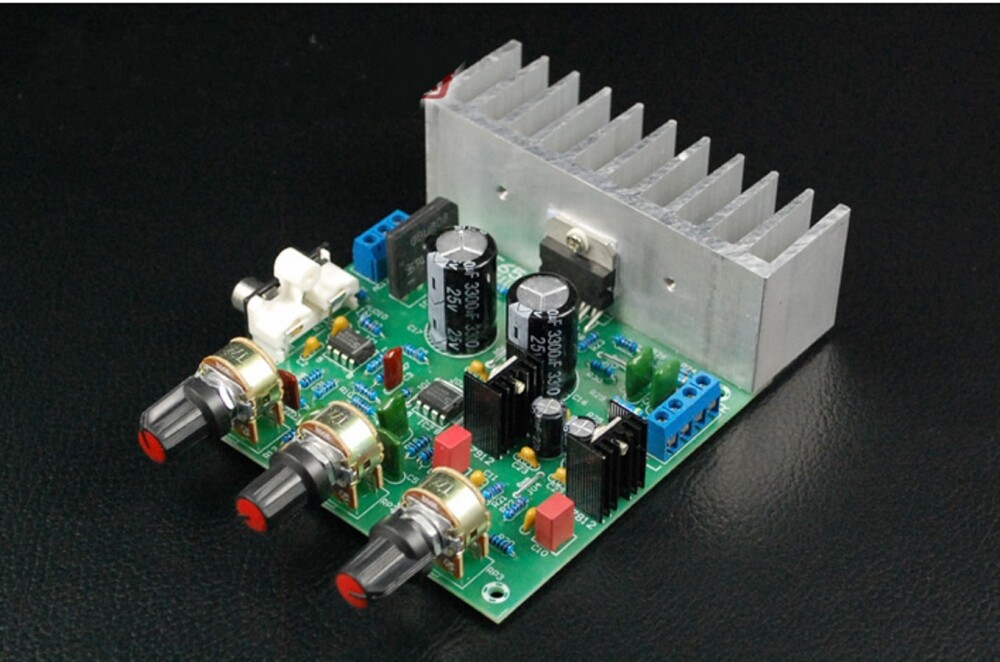

If you want to build your own amp into the speaker, you can get a T-amp board like this (
https://www.ebay.com/itm/HIFI-30W-2...286027&hash=item4b632bd48f:g:X2cAAOSwNnFcvobD). <- this is just a random selection that is stereo with bass/treble, there are others that have built-in bluetooth, 2.1 (i.e. contains third amp to drive a passive sub), etc. I've used boards like these also and they sound great. The only thing to keep in mind is that knob shaft / nuts are very shallow, so they need to be mounted to a thin panel. Parts express has these also -- couldn't find the one I wanted in a quick search, so posted this one off eBay.

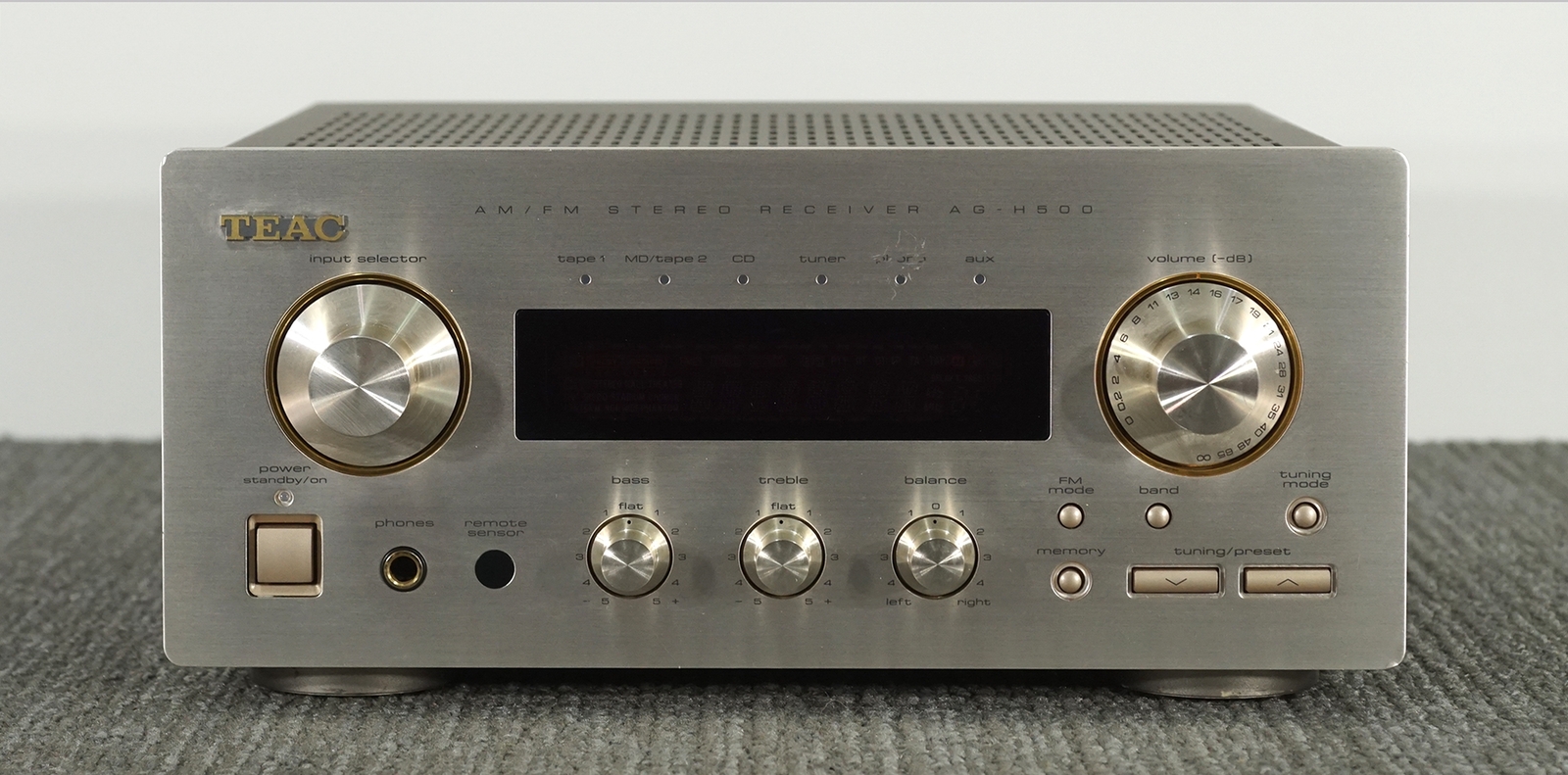

Another option is to look at is Teac's AG-H300 or AG-H500 mini receivers from the 90's (I think). They are Teac's tiny "reference" receivers -- they look awesome, are built like a brick, sound great, and have a built-in phono input. If you look around, you will probably be able to find a used one in the neighborhood of your budget.
Denon, Yamaha, and Onkyo also used to make similarly sized receivers, but I don't know if they have phono jacks and I don't think they are the same quality as the Teac reference receivers. The other mini receivers are just that, the Teac mini receivers are top notch quality receivers that have been shrunk down. I have the Teac AG-350 (which is a Dolby Digital mini receiver that does not have a phono input) and that little thing weighs 17lbs.
