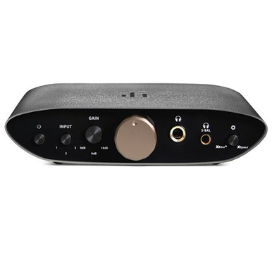

I have the ifi ZEN air CAN and the original Schitt Magni....both are very good headphone amps.
