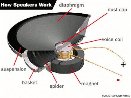

If I am understanding correctly, the HF that reads 0 on your meter has no continuity between the + and - post on the driver. You said it doesn't even blink. In simplistic terms the wire from the + terminal (tinsel, often larger than the voice coil wire) may be joined to a thinner wire that is wrapped around the voice coil many many times and the other end comes out (may be joined again to tinsel)) and goes to the - terminal. Could be the wire is broken, sometimes where the tinsel is joined to the voice coil wire) sometimes a sort of easy fix, sometimes more difficult.
A bit more difficult for me at least, is the lowered resistance reading for the other unit, 1.1. That would suggest the circuit from + to - is complete but something is not right. Someone smarter than me could hopefully say why.

Also is this voice coil inside the tweeter or the cabinet? Where would the broken wire be fixed?
No, connect the tweeter to both wires in the good cabinet and see if it makes sound.
The voice coil is the small wire I mentioned earlier.
The + and - in that picture would connect (it's soldered) to the thicker tensil wire which then goes to the connection terminals
The tensil is the thicker wire from the terminals to the smaller voice coil wire
If the wire is broken it could be right at the terminal, or where the tensil is soldered to the voice coil wire, or in one of the many turns around the voice coil.
Below, see the two "blobs" at about 11:00, that is where the tensile meets and is soldered to the voice coil wire.
