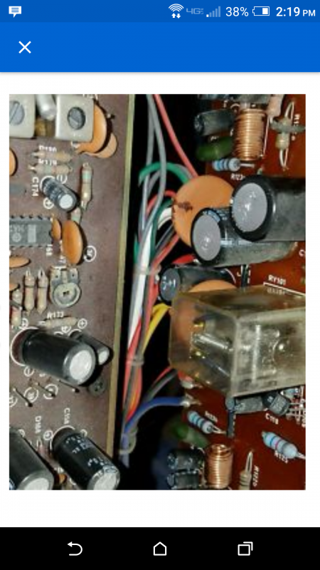

I could be a dick and refuse. But I'm more inclined to not be. I like the guy, we've talked a lot back and forth. And I believe what he's telling me. I would rather pay someone up there to fix it. He took the case off and says that there's a couple of caps leaking, (Which makes sense) and that the only repair shop around there wants $100 to open it up and then charges from there. At that price I'd be better off to just accept the return.
He sent a picture and it appears to be one of the dime-nickel sized tan ones and possibly a (half a AAA battery sized) canned one. They both look to be relatively easily accessible.

Many manufacturers used glue to hold components on the board during assembly, this glue may make it look like a capacitor is leaking when in fact it is not.

This is the picture I was sent. I can't make out anything that's obviously a leaking cap. That stain looks a lot like glue to me.
