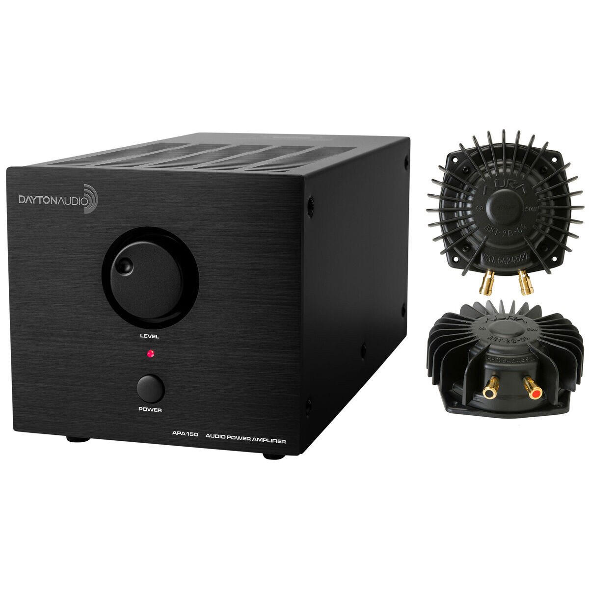

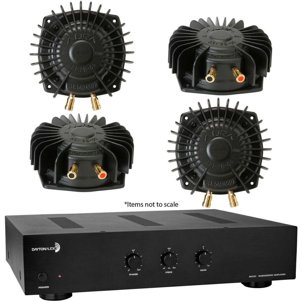

I would think seat shakers would be a better option. The Aura Pros below are very good. I'm using 8 of them -- 1 for each of 4 theater chairs and 4 for my son's sim racing driving rig. The shakers are pretty amazing when dialed in properly and are very powerful.
"Buttkicker" is the name everybody knows with shakers -- but I hated my Buttkicker (amp issues, clacking sounds, long-throw piston isn't as good for vibrations). I think the Aura Pros are better generally, and especially for something subtle like cat purring (versus a movie explosion), and they are a hell of a lot less expensive than Buttkickers.
How good are the Aura Pros? My son accidentally unplugged my 18" sub and I didn't even notice it for a while. Much more shaking/vibration power than a sub with zero unpleasantness and zero "room blasting" required. One shaker per chair would likely be enough.
You can use any sub amp (that has crossover and level controls) to drive the shakers -- 25 watts per shaker is plenty. Shakers can be purchased individually, but (for simplicity) here are some bundled shaker/amp options:
https://www.parts-express.com/Dayton-Audio-APA150-With-2-Aura-Pro-Bass-Shakers-Bundle-300-9004
https://www.parts-express.com/Dayton-Audio-SA230-With-4-Aura-Pro-Bass-Shakers-Bundle-300-9006

I'll look into a seat shaker as well but to be honest I feel that may be too invasive to the actual therapy session. It's meant to accentuate the therapy not override it. Can they be set to specific frequencies or do they just shake at a set rate?

I think it makes sense to start with the HSU and then see if it needs to be supplemented with shakers. To answer your question, shakers are almost exactly like a sub in terms of both feel and control. You typically have a crossover control (usually set lower than the sub) and a level control just lie a sub. It feels exactly like a sub, but it's more powerful without filling the room with sound. As I mentioned, I had my sub accidentally disconnected for a while in the theater room and didn't notice it because of the shakers.
With movies, the key is to make sure the crossover is set exactly right -- usually somewhere around 40-50hz -- you want it to capture just the effects that should legitimately cause shaking. If crossover is too high, they will shake for things that shouldn't induce shakes and become annoying, but when you have it dialed in exactly, it's pretty damn amazing -- and you can control the intensity level from subtle to pretty intense. The term "shaker" is a bit misleading -- if feels like the deepest sub ever rather than actually shaking. In my opinion, shakers are probably the biggest bang for the buck (pun not avoidable) affordable upgrade for movie use. I think you're correct to evaluate the HSU first and then determine if shakers can supplement that.
