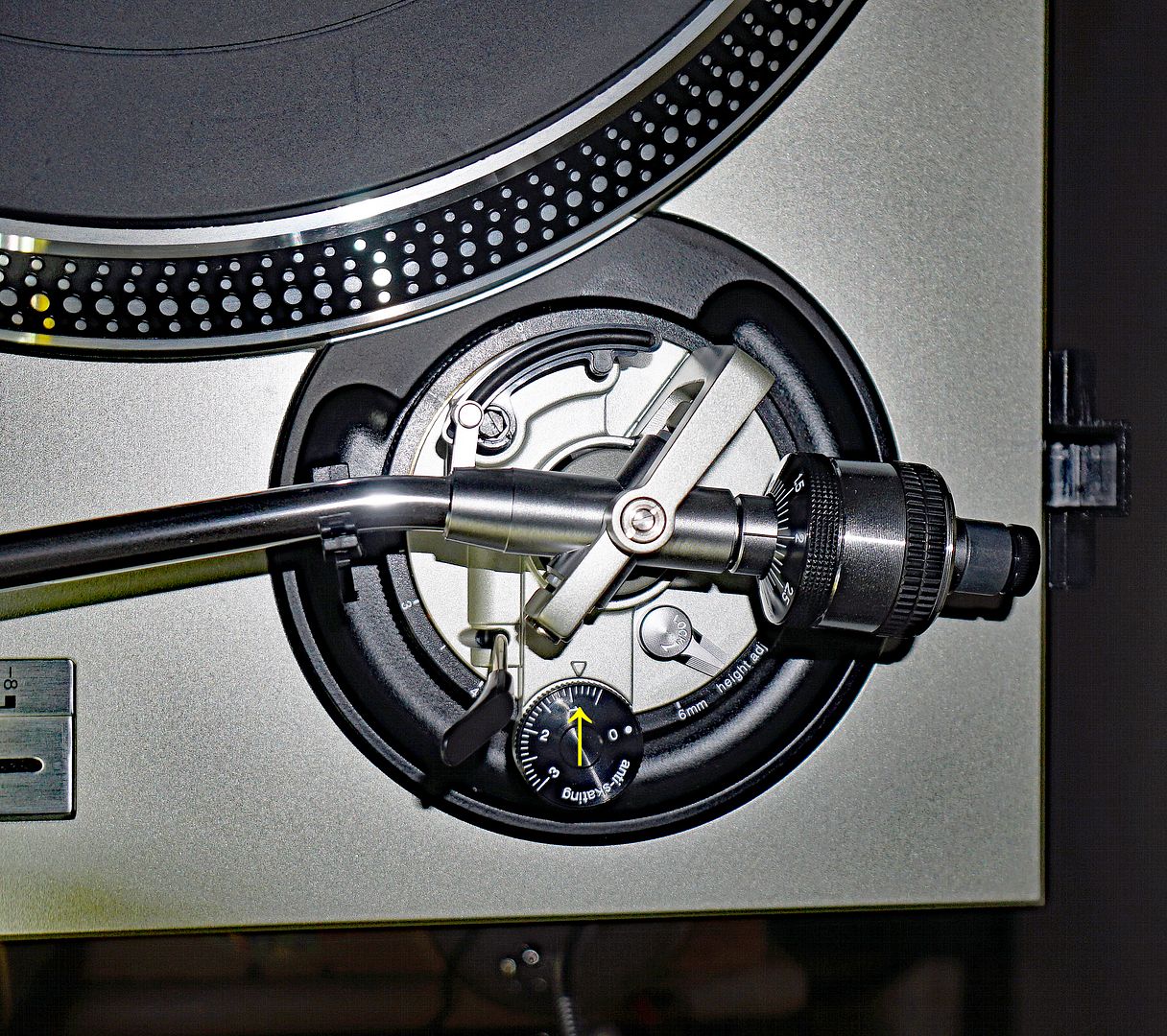

This could be an anti-skate setting issue. How did you adjust this setting?
I use a test record. That seems to make the A/S the best for the two tonearm/cartridge setups I own.
Thanks for the welcome, Mr. Boochie!
At the moment, I have the anti-skate set to 2.5. The scale on my turntable goes from 0 to 4, and I simply matched it to the tracking force recommendation rather than using a test record.
A test record sounds like a good investment, though. It would be nice to know the adjustment is actually correct instead of just relying on the dial. Thanks for the suggestion!

As an example, the Audio-Technica 33Sa MC cartridge on my stock Technics 1200MkII arm tracks at 2 grams. But the best anti-skate (using the Tacet test record) is 0.7.
Proper anti-skate setting can make a difference in right- and left-channel quality. Stereo focus and imaging.
