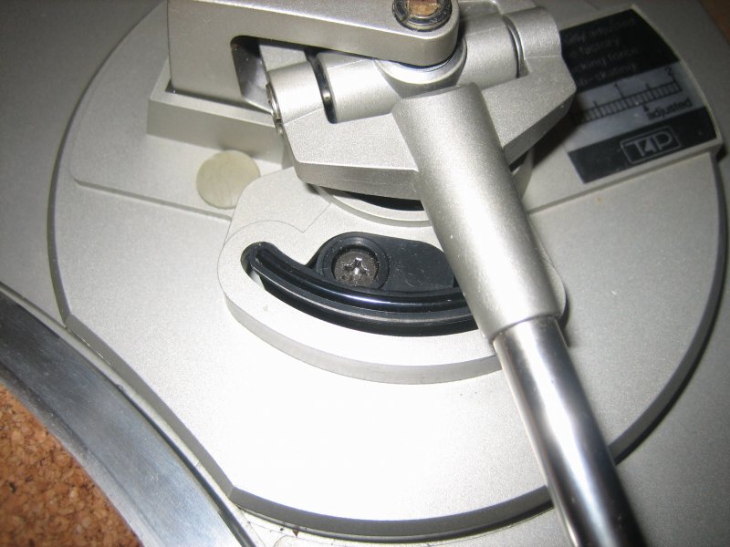

The one thing that worries me is the screw that I was referring to - the one not on the tonearm but near it towards the back that adjusts the arm height and hence the cueing height. I adjusted it down intially, then back up and it went way down, like something had been changed within the mechanism, and then after more adjusting up and down to try to improve the sound, it now needs 3mm or less for the stylus to cue down to sit on the vinyl. It's supposed to be 5-7mm and has been as much as a cm (I think) with the cueing going down to the vinyl. So something is definitely wrong there.

This is the screw to adjust arm height, anti-clockwise for up, clockwise for down:

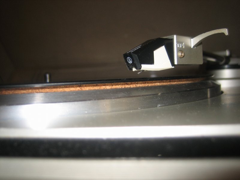

This is about the maximum height I can now get the needle from the record (after playing with the screw above) for it to still drop onto the record:

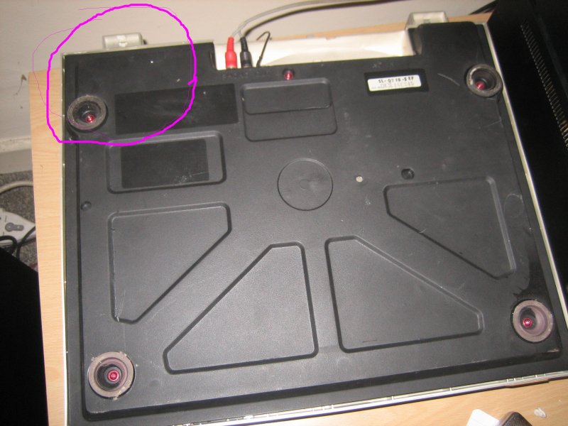

These are the feet. They actually seem in good order, although where I've circled top left the bit of the body next to the foot at the back (under the lid hinge at the corner) touches the table the whole thing stands on (EDIT: now I've confused myself, think it might be the right hand side, not the left):
Bit of good news. In flipping the turntable over I noticed that the RCA cables were pushed in unevenly, so with some force pushed in the one sticking out to match the other one. Sound much improved I think, though it's morning here and I have things to do, so will not be playing more records until the evening.
Many thanks for the input. My main concern now is the arm height. It's supposed to be 5-7mm between stylus and vinyl, according to the manual, not 2-3mm. It could previously be higher with the stylus still hitting the vinyl on cueing down, before I messed around with that screw.
I've just realised that it shouldn't matter how high the cueing goes, since the arm itself at the back is at a fixed height, so the angle will always be the same on the vinyl. It is a bit worrying that the cueing is impaired - it could conceiveably stop working in future - but the table for now works OK, and I can always drop the needle manually if the cueing does fail, as I've done with DJ decks.

Urgh no I'm not. The maximum cueing height is now just one mm, so the auto return scratches right across the vinyl. No more record playing until I can fix it.
Found this: https://forums.stevehoffman.tv/threads/technics-sl-q200-arm-wont-drop.490314/
Have asked on that forum exactly what they are doing. I can take out the screw completely, revealing not much, but I wouldn't know how to remove the saddle and take a proper look; maybe the tonearm needs removing first? I've got a birthday coming up and a family member might stretch to a new SL-1500c, but it seems a shame if this can be fixed instead for much less £££.
EDIT: The Sl-Q200 service manual indicates that removing the tone arm could be a big job, involving some soldering. And that's if it's even the same mechanism as the 210 (which is different, no strobe for one). There appears to be no service manual for the 210 anywhere on the internet.
