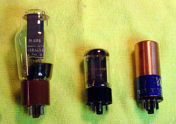

I started having "issues" with the Phillips big bottle here. That's actually a 5R4GYS that pulls more power for operation. I noticed over a couple of sessions that I had to set the bias controls higher, so I pulled it for the Copper Cap. Come to find out, it may just have been some power problems due to an "upgrade" on the local grid, and I also had some flakey bias pots in the amp. Thanx for the reminder. I'll plug that sucker back in tonite and see what happens.
PS ... if anyone's wondering why we refer to the Phillips as a "big bottle" ... well ... a picture is worth a thousand words.
Always looking for new options though ...
Right now I'm using an Amperex Holland 5AR4. It's a very fine tube and replaces a solid state Copper Cap WZ68 that I'd been using with good results . That replaced a Shuguang 5AR4 that just plain scared me with it's nuclear glow ... you can dang near read by one of those things ... <G>
I don't think that's the "big bottle" Philips tube he's referring to... Philps bought Sylvania and continued manufacturing some of their tubes - 6DJ8, 6L6 and 5AR4 among them. When the military wanted spare 5V4 tubes, they relabeled some 5AR4s. When they needed 5881s, they stuffed 6L6GCs into the shorter bottles.

Yep - that is the one - very pretty tube. I have had two of the webers - one went south and took out one of my output tubes - I've since bought two more - for back up - as they were stable for a year. So far no issues with the Phillips - but I'll now keep an eye on it - thanks Skizo

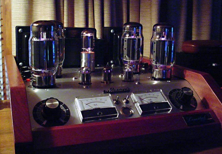

See the nuclear glow of the Shuguang 5AR4 here (front tube on the left amp):
(Photo is from audiophile03's system pics here.)
The 5AR4 in the right amp looks just as "nuclear" here, though! I sold these amps to audiophile03, and IIRC that's either a GE or Sylvania 5AR4 in the right amp. But might have been replaced with something else before the photo was taken...
Shucks, I was hoping for a nice blue color. Odd as it sounds, nuclear material under water makes a lovely bright blue glow. Cherenkov radiation is the fancy name for it, but it looks quite cool. The brightness of the glow around individual sections directly relates to the activity level.
