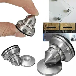

If your new gear doesn't have feet you should acquire some before stacking them. Quite a lot of pro gear doesn't come with feet. The bridged Crown XLS-2002's I use to drive my subwoofers came with no feet. They are both sitting on height adjustable spikes on a single amplifier floor stand.
The stand and spikes are through Amazon.
Here is the stand (from Monoprice).
Here are the feet (from Amazon).
