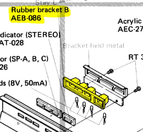

The unit is in really good shape minus some minor surface scratches on the top silver plate and it does work however I know I'll need to get it in tip top condition with a service and recap. I did order some led wedge lights from Dgwojo and when I went to place them I noticed that part of the lamp assembly where the "stereo" light looks like it's a bit melted and deformed.
As I'm a bit OCD I've been looking and I have identified the part to be a Rubber Bracket B from the schematic but wondered, is this a part that is universal other units? To help widen my search at least. I also put a Bartertown WTB to see if I can get a new one.

It would probably be the same part on the higher end sx-x50 models that use 3 speakers such as 950,1050, not sure about the 850. You can verify by looking at the service manuals for each model

Wondering if can heat it up evenly with a heat gun and get it to reform it's shape as it cools. Maybe block it somehow to keep it square as it cools. That is if it is not actually melted in places.
sadly these suffer from heat badly and were originally white but most of them are very yellow nowadays and the ones that have been used regularly are somewhat burnt from the heat of the incandescent lamps. This is the only place where LEDs have an advantage.
Well I ended up finding an entire 950 dial scale with both entact pieces of the rubber bracket, so I ordered it for a replacement. One guy in the Dominican Republic wanted 180 bucks just for the rubber bracket B and I got this from Minnesota with the face and both for $40 shipped.
