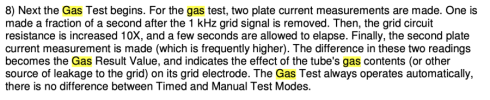

Here is the result screen. Gas on lower right. How the Amplitrex does the Gas test is shown in the second photo

So, it's not measuring grid current, but rather the difference (increase) in plate current that occurs when a high resistance in inserted at the grid. I would want to know a lot more about this test before discarding tubes. For example, does it use a different grid resistance for different tubes? Also, how does the test resistance for a particular tube compare to the resistance present in a typical amplifier circuit? Really, this bears further investigation.

Well, thought I had word searched the complete user manual for mentions of Gas testing. Evidently got distracted and never finished that. Here is a screen capture that talks about interpreting Gas test results.

Grid current is measured in microamps.. Usually abbreviated as "uA" since it's hard to type "µA". 1 microamp will shift grid voltage by one volt more positive if the grid resistor is 1 megohm (it's usually lower). Most critical with high transconductance tubes like EL84, 7591, 8417, EL34 that allow high grid resistors to be used. A 6V6 or 6550 circuit can live with more grid leakage than EL84 or 7591, since lower value grid resistors must be used. And its effect varies by circuit - a Stromberg ASR-433 with 100K grid resistors will be less sensitive to grid leakage than a Fisher X-100 with 330K grid resistors.
This tester is measuring the change in plate current (mA) when the grid resistor is increased 10X (which increases the effect of grid leakage). Best measured after some warmup time as it usually gets worse with temperature. Since they don't tell you what grid resistors are (I'd guess 100K and 1 meg), it can't readily be correlated with other testers.
And while we're at it, grid current can be due to gas, grid emission, or contamination on the mica insulators or the glass near the pins. But the measurement and result is the same. The first cause may clear up with use (if the getter is still active), the other two will only get worse.
