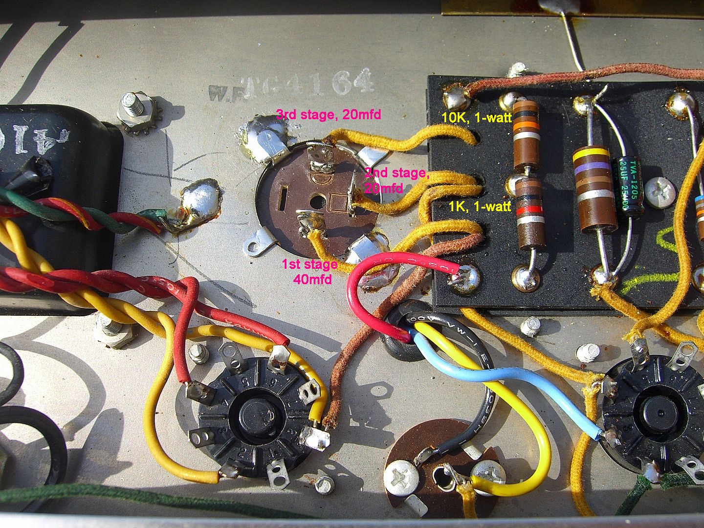

Post close-up photos of the circuit board. Especially the work that was done. It helps the diagnosis.
Kinda like these.

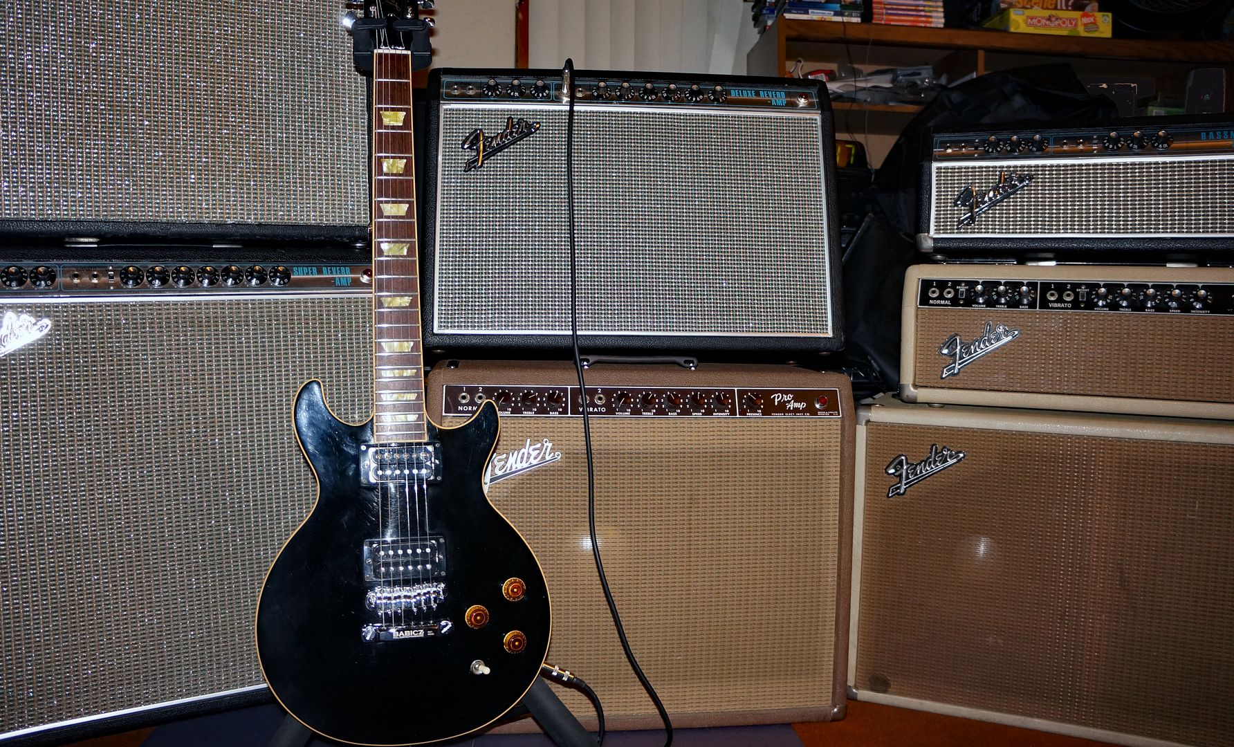

One thing that I like about guitars and guitar amps is that you spend some time and money to fix them (hopefully correctly ;)) — and usually they sell for the investment spent. If not more.
Some of my amp porn.
Very nice! I'm mostly a Vox guy myself. Though I've heard a few Fenders that I'd buy if I could justify any more amps.
I've got a '90s AC30, a modern AC10, and a customized take on the original AC15.
