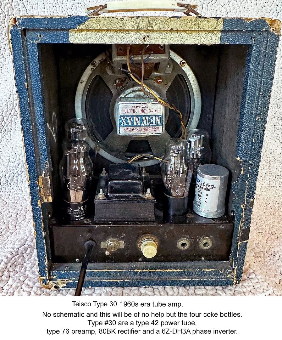

Hey All,
I just bought a Teisco tube amp that I'm going to restore and can't identify one of the tubes.
On the bottom is printed 29-L but I believe it's just a batch number as it's on another tube whose model number is clearly printed on the glass.
It's a 5-Pin Nikken Denshi and google lens said it's most likely a UY-76 but I wanted to post a photo here too, in case someone has seen one before.
Also, ALL of the resistors are wire-wound resistors. Any thoughts or experience coming across such a design?
I'll assume it's the UY-76 but for safe measure wanted to get a second opinion, thanks!

wirewound resistors are very stable and very quiet. They do have some small amount of inductance but generally its not enough to bother anything in the audio band, but at the same time it serves as a nice stopper for RFI.
If Japanese tube numbering mirrors old US stuff, that won't be a 42. The US 42 at least is a power pentode, 6F6 predecessor I think. Unless its the 6K6 predecessor. I forget, one is a 41, the other is a 42.
A 76 is a single medium mu triode. Internal construction certainly looks right for a single indirectly heated triode.
Ok thank you. Yeah, it looks like the UZ-42 is a 6 pin, unless I'm reading wrong. The one I have is a 5 pin.
Through google lens, it says it's a Teisco Model 15 (Not to be confused with the checkmate 15). I have only seen similar "looking" amps on for sale sites when typing that in.

My guess is a #76 tube. A five-pin single triode.
Your tube.
Arcturus #76 triode.
I think the caption is wrong. Mid-1950s-era combo amp. The 6Z-DH3A (diode-triode) is maybe another gain stage, or in a fixed tone stack. :idea: The amp appears to have a single-ended #42 output tube.

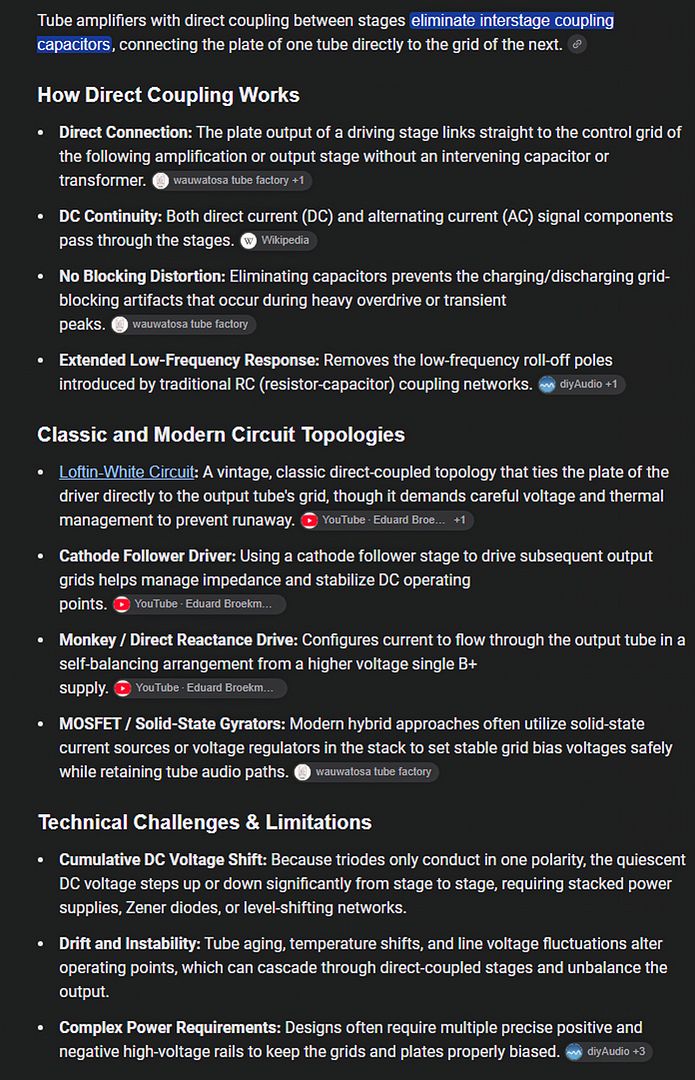

Some amps have direct coupling between stages. Two types. 1.) The cheaper end, low-powered ones (to save $ on caps), and 2.) The higher-end ones to get cleaner resolution. The higher-end ones tend to have stricter electrical parameters within each stage than amps with coupling caps, to maintain section stability.
some things also skip the input coupling cap. In theory, its not needed since the source isn't supposed to have DC on it, but many things include one so crappy sources don't cause problems.
Ok cool good to know, thanks guys.
