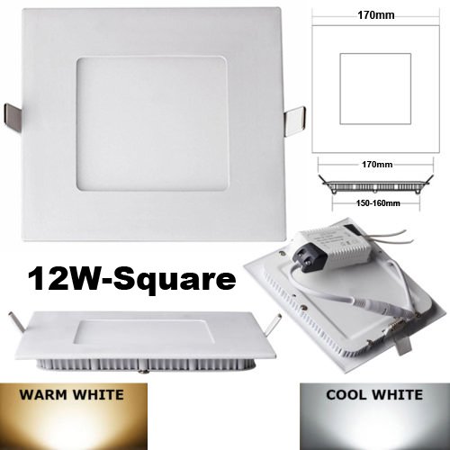

PS ... I've got a few lamps here that are problems. I "upgrade" a couple recessed hallway fixtures and put a motion sensitive lamp on the garage. Both of those just flat out scream on my radio receivers. I suppose on the bright side, no one can sneak up on me in the driveway when I'm listening. ;-}
Here's a pic of the hallway lamps I used ...
