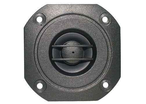

In the process of building a small vintage sound system for my daughter so she can listen to music with something else than her beer-can-size BT speaker (or directly from her cell phone) I bought a pair of Realistic Nova 6 speakers for $20. The cabinets are in VERY good condition, not a nick, sharp corners, etc.
The issue is one of the tweeters has been replaced by a previous owner. I don't know the brand of the tweeter they put in but I can say that it doesn't sound as good as the original one in the other cabinet. I think this replacement tweeter doesn't go as low as the original, and there is something missing in the upper mids (crossover frequency is apparently around 2200hz). It's not too obvious in casual listening, but when paying attention and playing with the balance control to compare, there is definitely a difference between both speakers, the original one seems "fuller" (sorry for the audiophile technical term!) and I like it much better.
The original tweeter is an 8 ohms 3" cone paper model 0735, Freq response from 300hz (!) to 18kHz, 5W nominal 10W max. They are known for being somewhat fragile, and I also know that the only Realistic speakers to use this specific tweeter are the Nova 6 and Optimus 1B (same speakers basically), so they are quite rare in the used market (I can't find any right now).
I'm not the first one to look for Nova 6 tweeter replacements, there are a few threads on AK about it (some more than 15 years old), and after reading through much of them I came up with quite a few options, which kinda confused me a bit, and that's why I'd like to revisit the subject and hear about opinions from those who have experience with the suggested tweeters.
Bear in mind: I'm in Canada (shipping from the US can be super expensive), I'm on a limited budget (paid the speakers $20, I don't want to pay $50 for a tweeter), I don't expect the Nova 6 to turn into Advents or Dynacos, but I'd like to get the sound at least as good as the originals, without the upper mids drop I'm currently having. I'd like to replace both tweeters so both speakers sound balanced, I don't want to rebuild/modify the crossover (which is a single cap that I will replace), and I'd prefer a drop in replacement (no cabinet mod/cutting).
Options are:
1- Goldwood GT-25 3" paper cone. 8 Ohms, 40W. 1.5kHz-21kHz, Fs: 1kHz, Sensitivity 96dB. About $10.
I don't know the sensitivity of the OEM tweeter but it seems to me 96dB is quite high and I fear it would be too much.
2- Goldwood GT-302 2.5" dome, 8 Ohms, 75W, 4kHz-19kHz, Fs: 2Khz, 92 dB. $7.
(FWIW, this tweeter was actually suggested as one of the 'best option' by ChatGPT !!)
3- "Avalanche" brand dome tweeter from Maddison (electronic part stores in Canada). 8 Ohms, 20W, 2kHz-20kHz, Fs: 2Khz, 90dB. $10, made in China, specs quite close to OEM I think.
4- Dayton DC25T-8 Titanium dome, 8 Ohms, 50W, 3kHz-20kHz, Fs: 1468Hz, 93dB. $27 (getting expensive!) One member here (@uxwbill) has used these for his Nova 6s, there is a thread on AK about it and he made a YT video.
5- PRT-8 Phenolic Ring tweeter replacement for vintage CTS tweeters. 8 Ohms, 30W, 2kHz-18.5kHz, Fs: 1005Hz, 90dB. $31 (expensive).

Thanks Lavane for the feedback, especially on the Goldwood paper cone.
If budget wasn't limited I'd opt for the phenolic ring tweeter, but with shipping here they come up to about $86, more than twice the price of the Goldwood. I need to consider fitment in the existing hole also. Ii don't want to enlarge the hole unless I have to.
I took out the replacement tweeter the previous owner installed.
It is a Kenwood TO3-464-05.
I couldn't find specs for it, but I saw it is used in some Kenwood large 3-way speakers. Specs for these speakers show this tweeter crossover freq at 5000hz.
No doubt very inappropriate in a 2-way design with a low crossover point like the Nova 6s. No wonder I hear a dip in upper mids, this tweeter probably doesn't even reach down to the Nova's xover point.
As a reference, the tweeter opening hole in the Nova 6 cabinet is slightly over 3 inches, like 3" 3/32. The inner diameter of the plastic cub (seal) the tweeter sits in is about 2.75 ".
P.E. should have the measurements specs. In the description.
There is usually 2 tabs in the description. The second tab should give measurement specs. If not I can measure one for you when I get home later.
Yes I found the GT-25 requires a 78mm hole, which is exactly the size of the Nova 6 opening. So they would fit.
However, the OEM tweeter sat in a plastic "cup", to seal it from the woofer. Otherwise, since the Nova 6 is a sealed enclosure, I guess air pressure from the woofer could have affected (or blown) the OEM tweeter membrane. Now I'm looking at this GT-25 and wonder if it is sealed/protected by design, or if the "cup" (or similar air barrier) would be required. The inner diameter of the Nova's "cup" is smaller than the GT-25 by about 1/4in, it wouldn't fit.
I sent a message to QComponents, the canadian reseller of the GT-25 about this. (Edit: they responded almost immediately, the tweeter has a closed back and unnafected by the woofer's pressure, so it's apparently not an issue).

OK I received the GT-25 tweeters this morning. I first installed only one so I could compare with the original.
For the record, they fit the tweeter opening nicely in the Nova 6, I was even able to fit it in the "plastic cup" that's behind the original tweeter, although it is not really needed as the GT-25 has a closed/sealed back. However, the GT-25 doesn't match the original screw holes. The original tweeter is mounted with 4 bolts and metal inserts in the cabinet. I didn't want to go through getting the metal inserts out and reinstall them to fit the GT-25, I simply rotated the GT-25 45degrees, drilled pilot holes and use wood screws. Also, the spade connectors on the GT-25 are larger than the original so I soldered new ones on the wires. I saw a comment somewhere that there is no polarity indication on the GT-25, in fact there are plus and minus signs stamped on the small "cardboard" just beside the terminals, there are hard to spot but they are present.
So I fired up the beloved KA-4002 and played some music.
The GT-25 certainly add a bit of "sharpness" or "crispness" (audiophile technical terms here...:-) ) to the Nova 6s. But not in an unpleasant way. In fact, setting up the amp in mono, I could not hear a huge difference between the GT-25 and the original tweeter. I was concerned the GT-25's sensitivity would be much greater than the original, but in fact if one the tweeters sings louder, it's the original. And that's a big 'if', they are matched quite well.
So I installed the GT-25 in the other cabinet and tested again. Again, it feels like they go higher, but they are high frequencies that should be there anyway. They are not overly strong or fatiguing, the speakers are not "shouty", the tweeters blend nicely with the woofers, and I did not have to play with the tweeter level switches (kept them in Normal). Keep in mind I'm 59, worked all my life in a noisy environnment, I can't hear much above 12K and almost nothing from 14K!! They still don't beat my Dynaco A25XL, but to me, with the GT-25s the Nova 6s stays balanced and pleasurable, they are a VERY close match to the original tweeters and a GOOD replacement for them.
The Nova 6 pairs nicely with the old Kenwood, and my daughter, who is less than half the age of her new stereo, is happy too!
Next step is replacing the old electrolytics in the crossover.
Just did the recap. I replaced the electrolytics with films. Interestingly, in one of the speakers someone had been there before me. The cap wasn't original, and had been replaced with another electroytic, but a 2.2uF (required value is 4.7uF). I guess he didn't have any bipolar 4.7s around on that day.
I had to reinstall the new tweeters. The screw holes of ther GT-25 didn't match the originals, and the cabinets were not air tight. When slightly pressing down on the woofer membrane, I could hear some whistling air noise around the tweeters and the mounting holes. So I took the "plastic cups" out, fabricated new tweeter seals with some thin packaging protecting foam, and plugged the old holes. That worked nicely.
