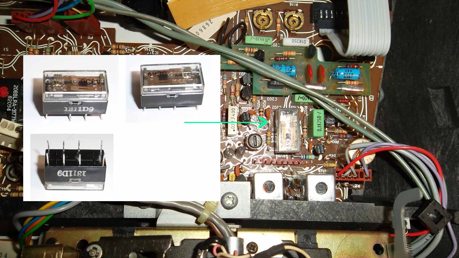

Looks like your head is modified. Here is a picture of my 8004 stock.
Do you guys also know where I can get a head relay. Looks like this is an Omron G2V-2 6-volts. I wonder if this Omron G5V-2-DC6 would work??
