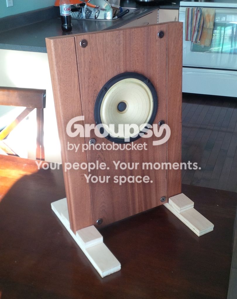

Latest incarnation of OB's in the house. Lcao 6.5" on a removable baffle in frame.
I plan to make a bunch of different inserts that I can swap with the removal of the 6 hex bolts. Allows me to have a number of drivers on hand to play with. Legs are temporary, baffles will be standing using some sort of mid-century-modern legs at ear height and will be matched to my Eminence Alpha 15" H-frames that will be hidden inside an MCM console that I recently purchased (which is already gutted)

i've heard great things about the LCAO drivers. what are your impressions?
I have about 20 hrs on them so far, and they are still opening up. I went with the ferrite magnet version, and I can say I am pleased. They work best with an active over as they do roll off a bit above 10k so I boost them there (I like bright sounding speakers). Very efficient and good voicing for $110/ pair can beat it.
