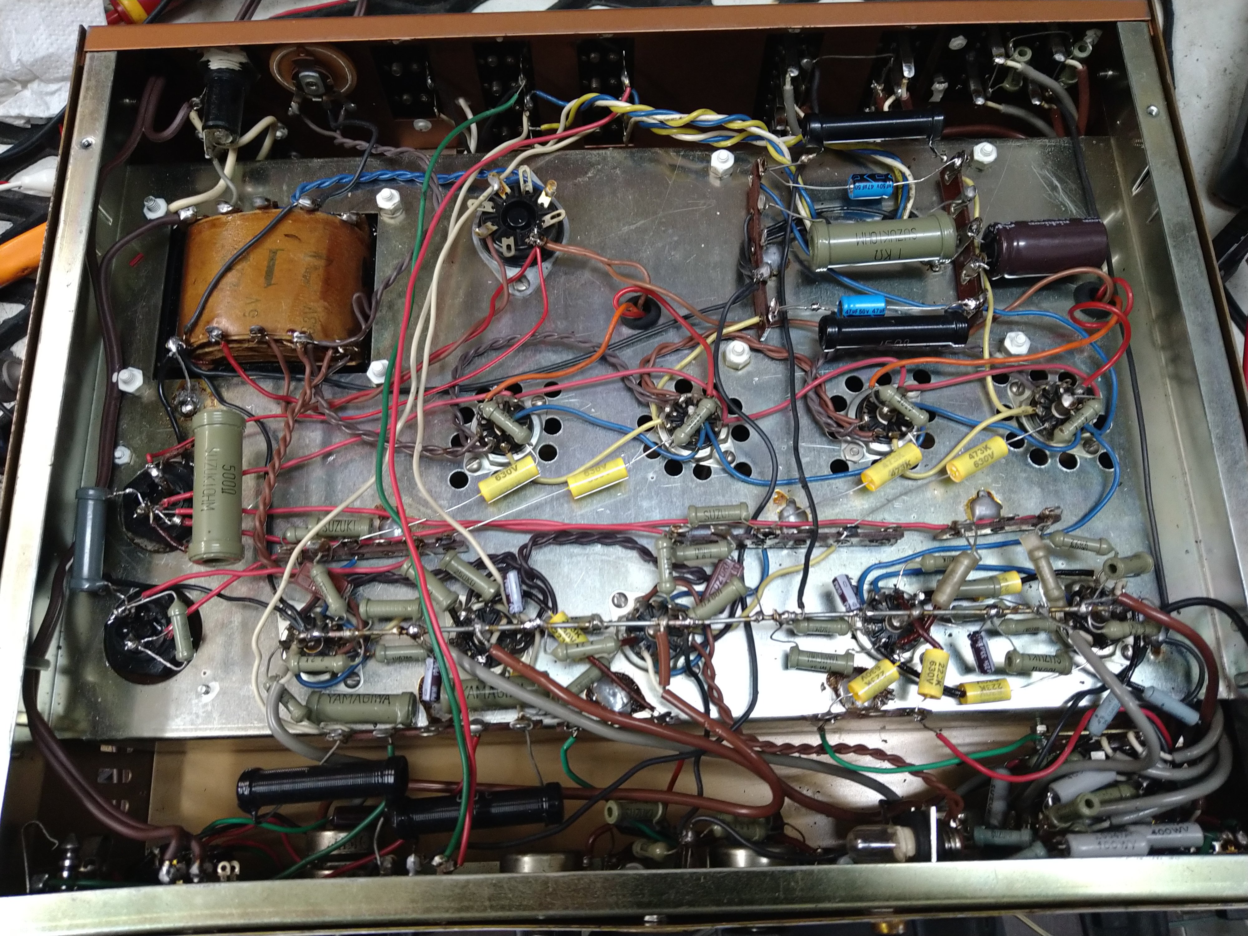

I'm trying to go through an unidentified model equiped with a 5AR4 rectifyer, four EL84 PP and 5 12AX7 (all testing good).
There's some residual audible ripple after recaping the power supply whatever the position of the volume control. A NOS 5AR4 didn't help, neither another set of EL84.
Components are essentialy Suzuki branded and the wiring is typical of a kit.
The two 12AX7 from the phono / tape head entries are DC powered from the bias circuit of the EL84.
The amplifier I'm working on doesn't have exactly the same housing / front place as this specimen but the chassis looks identical.

All the Olson amps I've seen are Japanese and their components don't seem to hold up well - especially the gray capacitors. You should plan on replacing every one of them.
It would help if you posed pics of the unit you're actually working on.
Agree, get those Suzuki PIO caps out of there. They could be leaking DC from one stage to the next. Might even be part of your hum issue.

The underside picture in the link you provided is blurry. Any chance you could take a clear photo of the insides of your unit and post it here? Someone might see something for you.

Noise issues can be caused by so many different things so you need to work through different areas. I noticed that there are at least 4 places where grounds were made with the chassis. This can cause a ground loop and you might want to redo the grounds if you can not get rid of the hum. Poor wiring layout can place an AC wire, like the filament wires, too close to a DCV wire which may induce hum into the signal circuit

Thanks for your answers. I already removed some black ground wires visible in the photo.
One wire was passing through the whole chassis to reach two power resistor grounding either the headphone or speaker terminals (whichever isn't used). As there was a ground point near those resistors, the wire was considerably shortened.
The black wires in the EL84 cathode resistor circuit were removed as well. The 1K cathode resistor was already grounded (as the mains power transformer is), so the black wire crossing the chassis was useless.
Even with these two mods the problem persists in both channels. I'll investigate more tomorrow.

I checked your photo closely and it appears to me that the cathode resistors are the 2 black ones that are on either side of the big green 1K resistor, which i believe is the voltage dropping resistor for the suppressor grid on the el84. And it looks to me that the yellow wires on the el84 sockets are the ones that go to the cathodes on the el84 sockets which is pin 3. And looking at the top of photo where the black cathode bias resistor is supposed to connect to the solder lug, it appears the the resistor lead is unconnected. So make sure that the 2 black bias resistors are grounded preferably to the same ground as the high voltage or B+ ground.
This is a picture effect. Both black 150 ohms cathode resistors are well connected. The remaining solder joints on their pins (to be removed later) correspond to the points where the 47µF cathode electrolytics were originally connected.
The cathode circuit of the EL84 is used to DC-power the two phono/tape 12AX7. In each channel, both EL84 cathodes go to the 150ohm resistor trough a yellow wire. The other ends of both 150 ohm resistors go to what I call the "blue point" as per blue wires, from which the filaments of two 12AX7 are powered. At this point, there is the big 1K resistor with a 100µF parallel smoothing capacitor (Nichicon PW radial in this case).
Note that each 470K grid resistor of the EL 84 go to the "blue point" as well. Not sure what this does as 1K is negligible.
