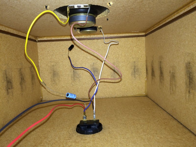

So took it home and the final troubleshooting test I did was swapping the woofers. I was swapping wiring/channels (L to R) and placement of the physical speakers and the "good" woofer did the same thing. Used Radiohead's "King of Limbs" for the louder modern mastering and that clear sub-bass and it seemed to handle the intro's bass of the drum loop but once the synth bass came in the tweeter and mid speaker were coming through clear but the sub from the other speaker that I put in did the same thing. Just crazy vibration. Doesn't have that flapping buzz of a torn speaker, just a rattling that beyond a normal loose casing sound that I've heard in guitar cabs. I'm attaching a picture of the innards that shows the wiring from the connector on the back of the speaker as it connects to the other two speakers and the loose wires that go to the sub. I have very little familiarity of the terminology or identifying the workings of any electronics really, but does there look to be a crossover in this picture?
