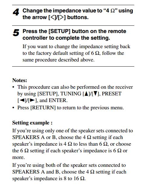

I did recently got a Onkyo TX-8050 stereo receiver and it says it's rated for 4 ohms to 16 ohms but is this receiver really a 4 ohms receiver? I did connect my JBL 4312M speakers and they seem to work fine when I select 4 ohms in hardware. There was 4 and 6 ohms selection. Each time I change it it makes a click sound so I thought maybe it's just a switch inside that changes it from 4 ohms to 6 ohms. Also seems like if I had 8 ohms speakers then I should set it to 6 ohms since there is no 8 ohms as a choice.

The entire manual is available here ...
PS ... there is a note on another page that says you should not connect more than one pair of 4ohm speakers ... Also, if you connect two pairs of 8ohm speakers, you should set the receiver to 4ohm. As far as on the fly switching goes, not an issue. Worst that could happen is the internal protection could get confused resulting in no sound. That should reset with a quick power cycle.

Here is one thing I read that says about keeping it to 8 ohms or for me 6 ohms. But maybe this is only for Kenwood receivers?
"Some Receivers have an impedance selector switch. In most cases we recommend the 8-ohm or more setting. The manufacturer puts them there for UL/CSA approvals as well as easing consumer concerns about driving low impedance loads. These switches step down voltage feed to the power sections which will limit dynamics and overall fidelity. Keep the switch set for 8 ohms regardless of the impedance of your speakers and ensure proper ventilation of the Receiver."
