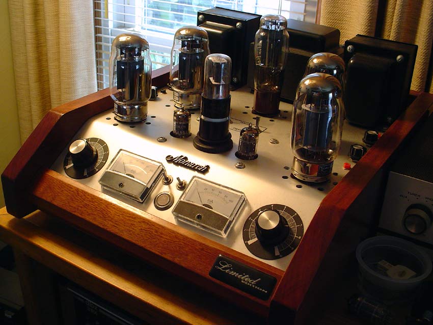

opinion of using a 6SN7 over a 12AU7 in an amp driver boards
Great. How many db is missing in the mid range? What frequency does it start, and what frequency does it get better?
Once you identify rolloff points you can start looking for time constants that correspond with them.
If you want to roll tubes, roll tubes.
If you want to diagnose a problem we can help with that too.
Rolling tubes isnt likely to solve a problem, which you cant identify.
I own over 300 6SN7's and believe on average that they are a better tube than the 12AU7, which I own over 100.
Even better are the previous generation the 6J5-GT's, the 6J5-G's and the British L 63's, each of which is the exact equivalent of one half a 6SN7 and there are ready made adapters available on Ebay.

try a 6CG7 or 6FQ7. Basically the same thing as a 6SN7 but in the smaller bottle. I'd be surprised if adapters do not exist to make it work, the only change is to the heater connections.
The adapters clearly exist . I have a couple.
FWIW, I had a VTA ST120
The driver board is the same.
I suspect I tried more variants than almost anybody ( 12AU7s and 12BH7s, also IIRC E80CC in the middle) I'd guess upwards of 75 versions in every position on the small pin driver board. ( I'm not sure but I think the board evolved somewhat since I built around '11).
At first I was amused at how the sound was altered by rolling tubes in it. Then I came to believe it was a flawed design because the tubes shouldn't alter a properly designed circuit.
At some point , I was exchanging messages with Kegger. He said the tubes weren't at their proper operating point and suggested the changing ( i think )3 pairs of resistors. I mention this because I think tubes4hifi actually altered the value on these resistors in later revisions ( let me say I believe I was told this , but I'm not sure , so don't take it as fact).
I did find after the resistor changes the tube rolling made much less difference. I have no measured test results, so take everything i say with a grain of salt.
Anyway, at the end , being so far down the rabbit hole i put the 6SN7 driver board. I thought it performed about as well as some of my preferred 12AU7 and 6BH7 variants.
There wasn't an OMG I can't believe I wasted all this time with the small bottle tubes.
I wasn't aware at the time of the 6CG7 option so that was never tried.
He said the tubes weren't at their proper operating point and suggested the changing ( i think )3 pairs of resistors. I did find after the resistor changes the tube rolling made much less difference. I have no measured test results, so take everything i say with a grain of salt..
I did try tweaking the plate voltage of the driver and inverter tubes. It did make an significant difference in sound. The only problem is I don't know enough about how to rebias those tubes. I understand the graphs, etc.... but in real life terms I'm not educated enough on how to refigure the entire circuit. I also don't have the equipment to be reinventing the driver board.
But yes, if I had the know how, I would rework the voltages on the driver tubes.

Less than optimal op points would definitely make a thing way more sensitive to individual tubes. For some that might be a plus, for me who hates having to own an arsenal of tubes just to find the magic one in a given amp that would be a nightmare. For me the ideal would be absolutely any tube that is in good electrical condition sounds identical.
Exactly. I hate having something that has to use the "golden tube" or nothing. If I can't use a wide number of "what ever's" then how good could that design be.
I have a bit of that problem with my CJ preamp. It can only use either a EH or GL 6922's because of how hard it drives them. And even the Gold Lions start to hum after about 9 months.
I'm getting too old to have picky stuff.
I've tried RCA 12AU7 clear tops, 12BH7's, E80CC's and ECC99's in mine along with several 6SN7's with an adaptor socket. I used one E80CC and two Philips 12BH7's for several years and liked it. I tried a 6SN7 and didn't really notice any difference between it and the 12AU7. In the end I settled on an old stock 12BH7 and two RCA clear top 12AU7's. The new manufacture 12BH7 I tryed I did not like much.
As mentioned, a 12AU7 variant amp usually is a bit of a compromise as there's so many tube types you can plug in with no mods. The CCS tail used in some of them does a real decent job of minimizing any inconsistencies, and also mostly eliminates any potential matching problems in the channel drivers.
That said, if you're really anal (sonically sensitive?) about it, you can find several mods that are alleged to result in improved sonics. I know of at least one that does the resistor swaps specifically tailored to the 12BH7 series. Never tried it here as I'm quite happy with what I'm hearing more times than not, and a simple swap cures any "problems".
