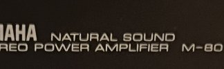

Hello fellas! I am hoping i can get an answer to a simple question. FTR, I have looked and read a good bit trying to find the answer. However i am confused & really want to spin vinyl. I have not played a vinyl record since the late 80’s. I have a Stanton 681EEE on a Kenwood KD-2055 TT. My question is this:
i just hooked her up to my Yamaha M80/CX800 combo (JBL4311’s & ADS L1230’s) and I do not know which cart setting to use on the pre amp. Pics included, I really appreciate any direct help.

47K/220 pF setting. You have to take into account the capacitance of the turntable cables, which add to the total capacitance loading on the cartridge. 150 pF is common for each cable, equaling 150 pF + 220 pF = 370 pF total.
